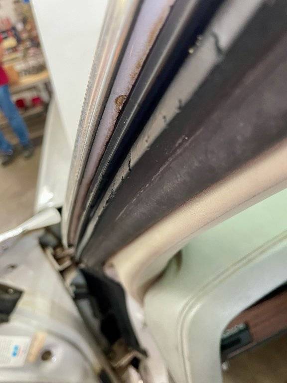

The roof rail molding on the New Yorker I just acquired needs to be replaced. Please let me know of reputable establishment where I can order roof rail molding. I need to replace on both sides of the vehicle.

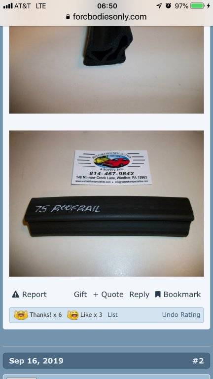

All the above is true, however! I found a company that sells weatherstripping that will work, they clams it’s a GM style. They sell it by the Foot. You’ll need 14’.. and when pulling the Old! Keep your corners!!! So do NOT get rid of them. Use your favorite glue to bond the corners to new weatherstripping.. when / If you call, they have it listed as “75RoofRail” weatherstripping.

I measured last evening. 14' total length. I have been in contact with Restoration Specialties, but they mentioned a different weatherstrip. I will contact them about this "75RoofRail".

You can contact both companies and have them send you samples of the weatherstripping, you can then decide which one works better for you. I have mine coiled up in a box ready for installation when the time comes.

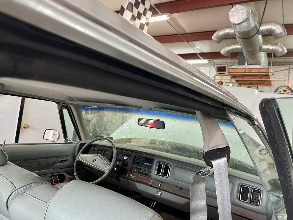

I ordered the roofrail weatherstripping from Restoration Specialties and installed over the weekend. Need to bond the new with the old, but she sure looks a lot better. Have to work on both rear windows since appears both are fully raised but they are not.
Now I need the window channel mouldings for all of the doors. The moulding that is afixed to the doors that the windows slide up and down through. I am calling Restoration Specialities tomorrow inc I could not find it in their catalog.
Thanks everyone for the recommendations on where to find the weatherstripping.
