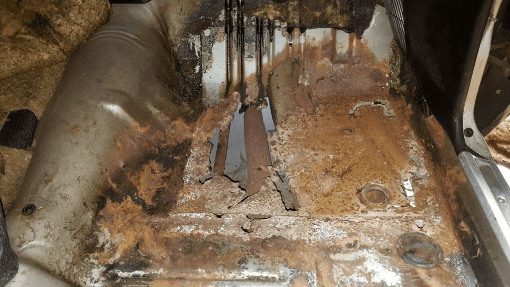

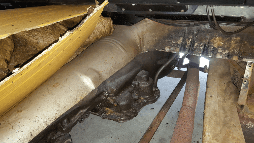

I bought the 300 a few years ago and knew there was some rust in front of the passengers seat……..
Little bit more than i expected……

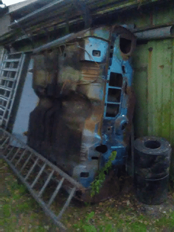

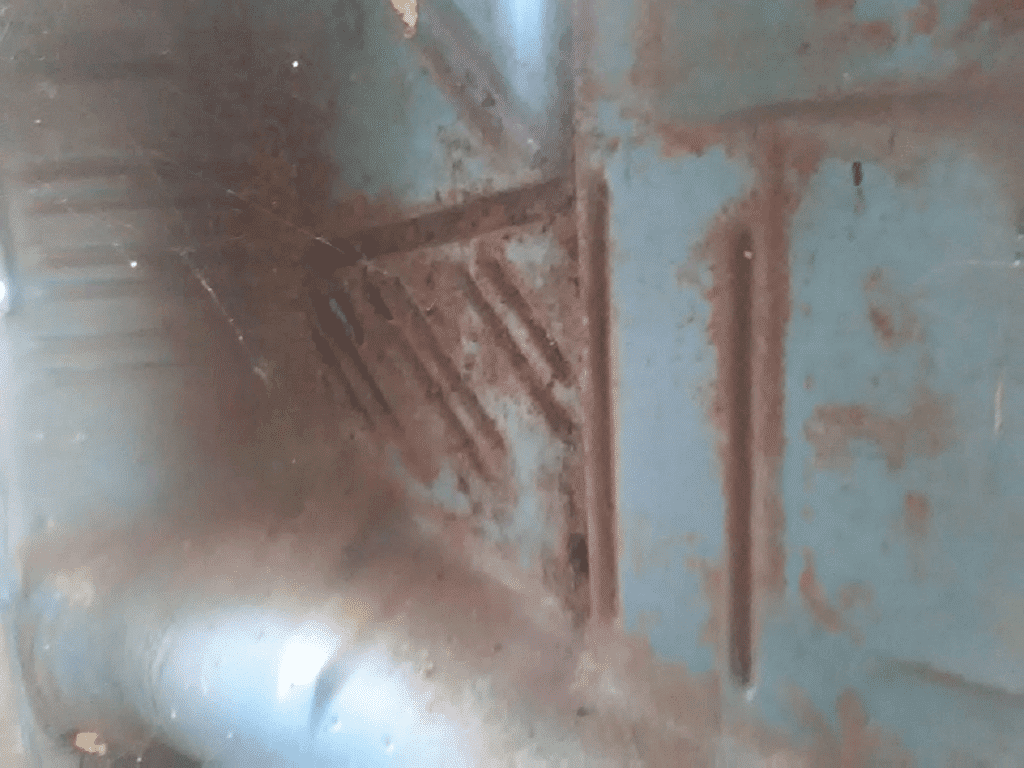

So i called a friend and he knew a parts car in the south of the Netherlands...

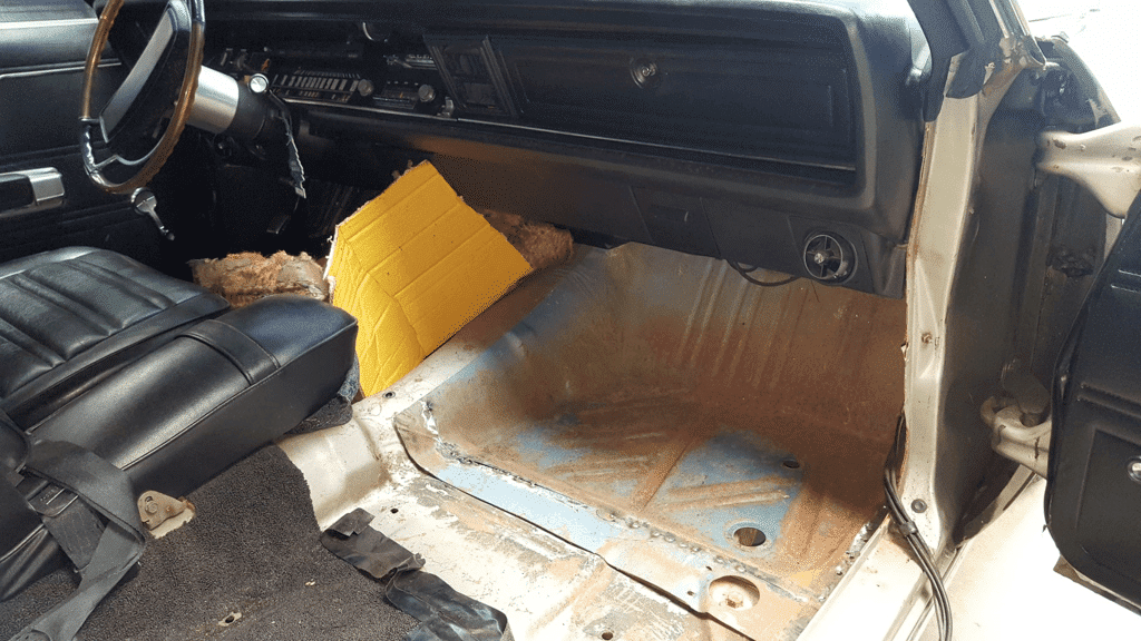

Cut out the good piece and took it with me...….

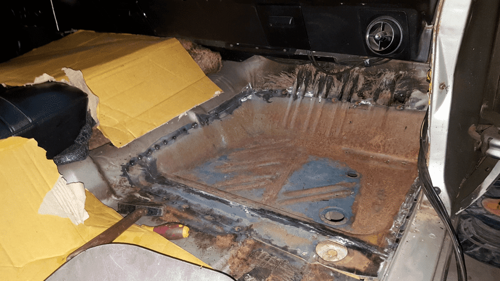

Long time ago that i did this kind of work but got motivated by a lot of guys here so ithought ...lets do it.

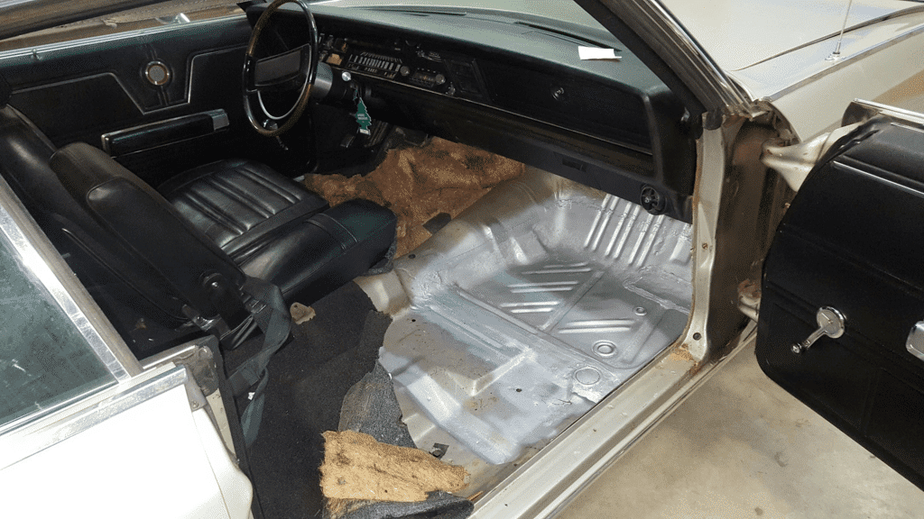

It cost me a few days but i think it looks good enough for the coming years…….
Thanks and i hope others here also get motivated like i did…….
