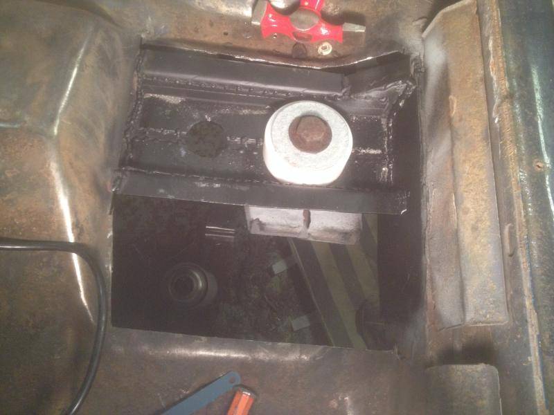

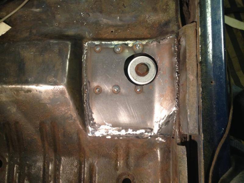

I made my own pucks out of Delrin for my -71 300. It works just fine and I cant notice any diffrence in handling at normal cruising.
