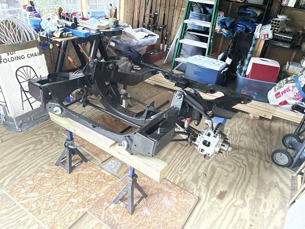

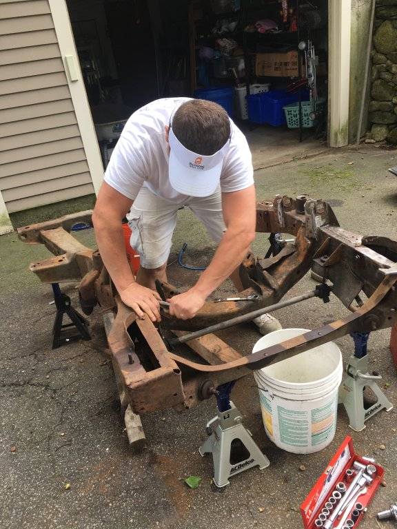

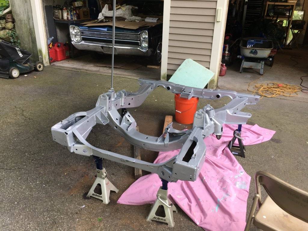

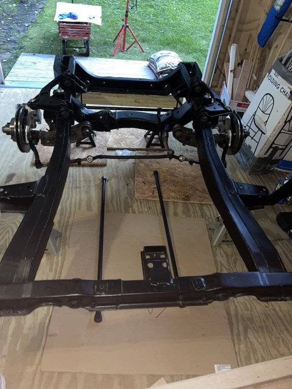

Many years ago I used POR-15 a truck. I bought the start kit and followed the directions. Top coated it with some Rustoleum spray bomb. a couple of years later when it cam time to paint it that stuff was rock solid. You would've had to use some very coarse sand paper to get through it.
