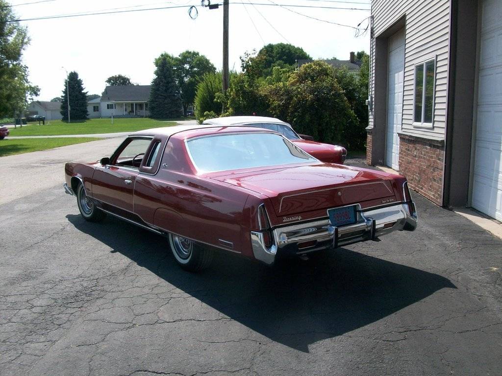

I agree with your comments of vinyl being porous especially when not maintained. But my '78 New Yorker St Regis Coupe had it where the factory drilled the holes for the edge molding and then never treated the metal where they drilled the holes.
