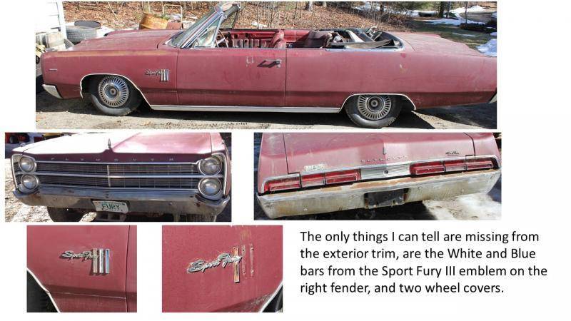

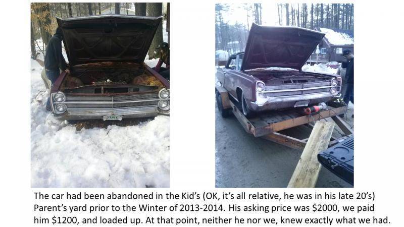

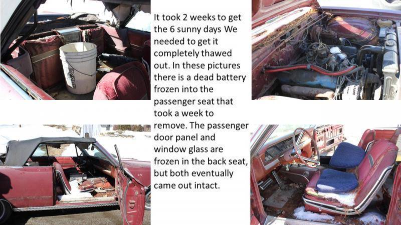

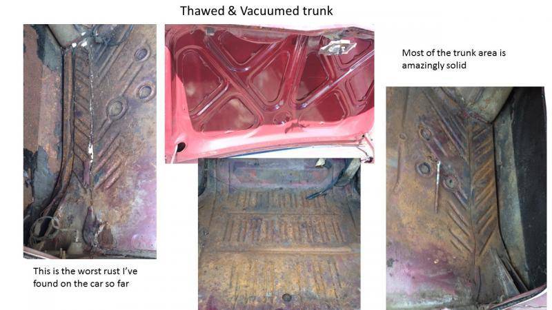

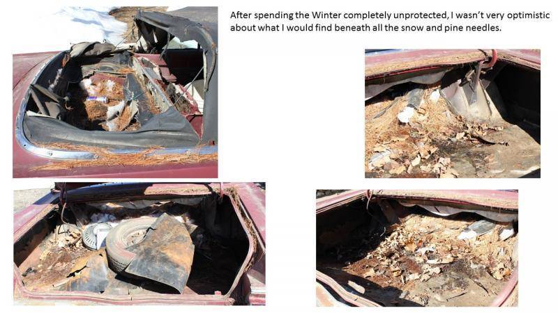

I'll re-cap what I've done to the car so far:
new battery, rebuilt carburetor, replaced fuel sending unit after cleaning out tank, replaced water pump, changed all the fluids and filters, found a faulty ground wire in the ignition system, and she fired right up. I set the timing, and adjusted the carburetor, and she fires up almost immediately every time. Discovered a broken T-bar on the driver's side so I haven't been able to see how well the transmission survived, although it seems to be well behaved at low speed moving it around in the yard. Thanks to folks on this forum for the pointers, Murray Parks is currently sending a suitable replacement T-bar, and the bump stops and dust boot are on their way from Firm Feel.
I intend to make it a driver for now, with the option to restore later so I ask this crowd for advice on what I can do (and should not do) about the top and interior. Must I go all out now and do the interior "right", or can I go cheap with the expectation that it would be redone in a proper restoration anyway?
I'll keep posting pictures as I go along, and appreciate any and all comments (favorable & helpful or even hostile).
BTW....pretty sure I'm not under water.......yet. With all that I've done (including the suspension parts that are on the way, I've invested less than $2000 so far. That's one solid car for the money, considering what I've seen others on this forum trying to save.
