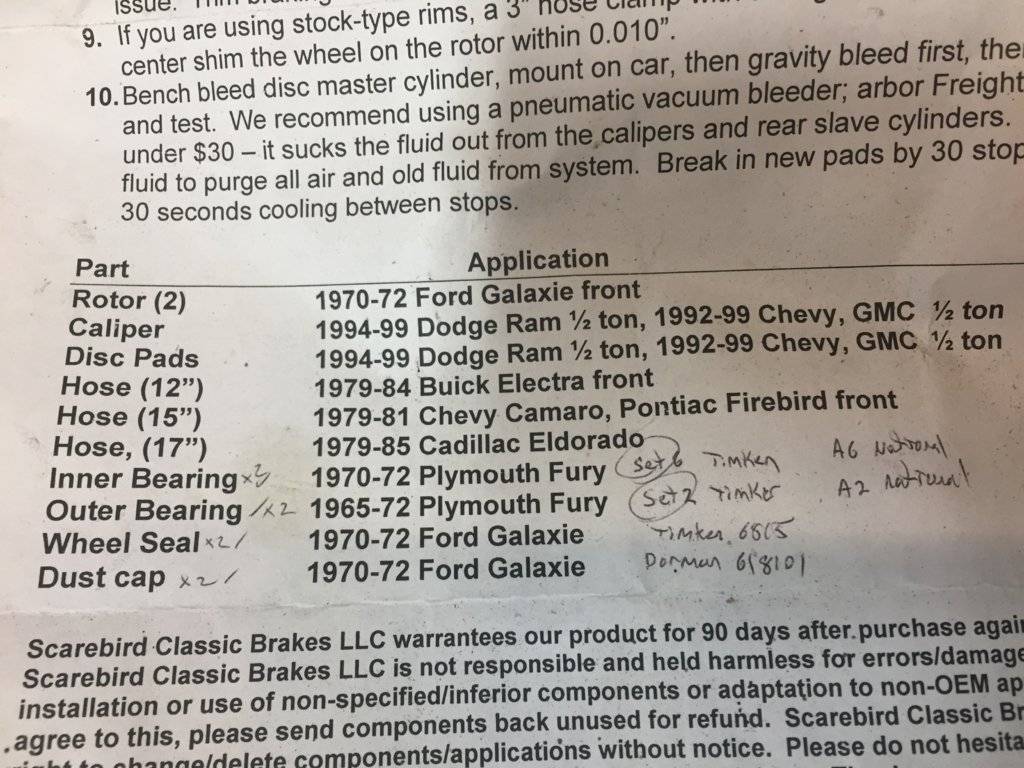

I collected some of this info awhile (3years) ago when I did mine and its about time I finish it and post it. I updated some of the links cuz some stuff has been discontinued. My 69 fury was originally a power drum car so no need for pedal changes and I didn't even need a proportioning valve. All totaled, with booster and master, about $650-$700.
Scarebird c-body write up. Old but accurate except my parts list was different than this one.
http://www.herrickenterprises.com/70duster440/public/ScarebirdConversion.pdf
Scarebird Adapters and hardware. $175
1963-72 Plymouth, Dodge, Chrysler "C" body with 4-1/2" bolt pattern front disc
Rotors (x2) - RAYBESTOS 6014R $90 total
https://www.rockauto.com/en/moreinfo.php?pk=1043019&cc=1498231&jsn=577
Booster and MC - A-1 CARDONE 503600 Reman. Vacuum Power Brake Booster w/Master Cylinder $130
I got mine from RockAuto but they don’t have it anymore so try - from advance auto
Booster alone - A-1 CARDONE 54-73309 $130
Duralast Reman Brake Power Booster 54-73309
Dust Cap (1 box) - DORMAN 618101 $7 (makes u buy 5)
https://www.rockauto.com/en/moreinfo.php?pk=12527&cc=1498231&jsn=5&jsn=5
**they did not fit perfectly so with some pliers bent the edges in just a bit and then they would hammer in.
Inner bearings (x2) - TIMKEN SET6 $10
https://www.rockauto.com/en/moreinfo.php?pk=1119632&cc=1440933&jsn=2
Outer bearings (x2) - TIMKEN SET2 $8
https://www.rockauto.com/en/moreinfo.php?pk=1116634&cc=1440933&jsn=3
Inner grease seal (x2) - TIMKEN 6815 $5
https://www.rockauto.com/en/moreinfo.php?pk=1119427&cc=1498231&jsn=4&jsn=4
Brake hoses. I got these and had to grind off the mounting bracket. Seems weird asnd I thought I did something wrong but I was dead set on the long 17" ones. I’m sure you could find a caddy hose with right length without the mounting bracket. The ones below do not show up in the RA list for the Caddy, but they are compatible.
Brake hose left - DORMAN H98914 $7
https://www.rockauto.com/en/moreinfo.php?pk=968680&cc=1026111&jsn=12
Brake Hose right - DORMAN H98913 $7
https://www.rockauto.com/en/moreinfo.php?pk=968059&cc=1026111&jsn=13
Rear RH lugs - WAGNER BD61235 $5 **with new RHT rotors the only LHT wheel would be drivers rear. I didn’t want that.
https://www.rockauto.com/en/moreinfo.php?pk=145904&cc=1232402&jsn=9
Calipers, the ones I got are below but they are discontinued. Pick what you want from this list. Since you likely will not have a core assume $140 for both if you choose pre-loaded.
https://www.rockauto.com/en/catalog....9l+v8,1354148,brake+&+wheel+hub,caliper,1704
Caliper right/passenger - WAGNER TQM25003 Discontinued!!!
https://www.rockauto.com/en/moreinfo.php?pk=1259030&cc=1354148&jsn=2
Caliper left/driver - WAGNER TQM25002 Discontinued!!!
https://www.rockauto.com/en/moreinfo.php?pk=1255005&cc=1354148&jsn=3
***and by the way since these calipers are from a RAM 1500 I looked on ram forums to see what they are doing to improve braking. One of the obvious answers was to use calipers from RAM 2500. So I bought these first. They were slightly too big to fit into the Scarebird adapter. I think with grinding they would have worked fine. But I wimped out.
Speed Bleeders - DORMAN 12702 $7 *not required
https://www.rockauto.com/en/moreinfo.php?pk=452835&jsn=1
Bracket $175
Booster & MC $130
Calipers $140
Rotors $90
Bearings and seals $23
Dust cap $7
Hoses $14
RH lugs $5
Speed Bleeders $7
Shipping???? $60??
Total - $651
