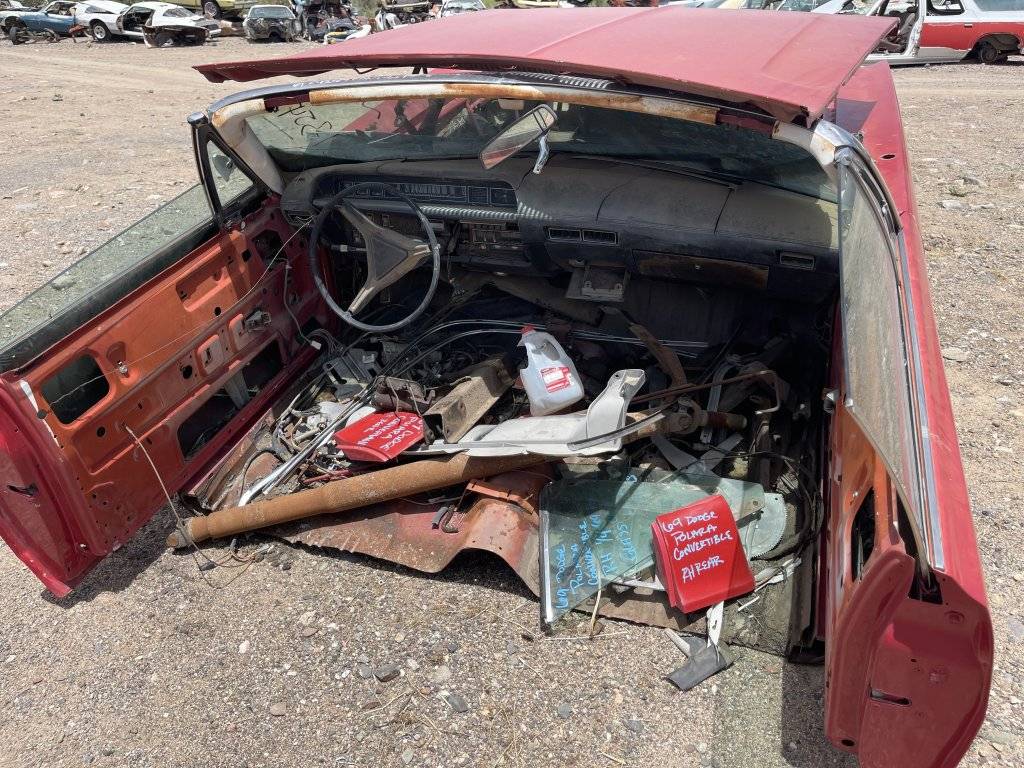

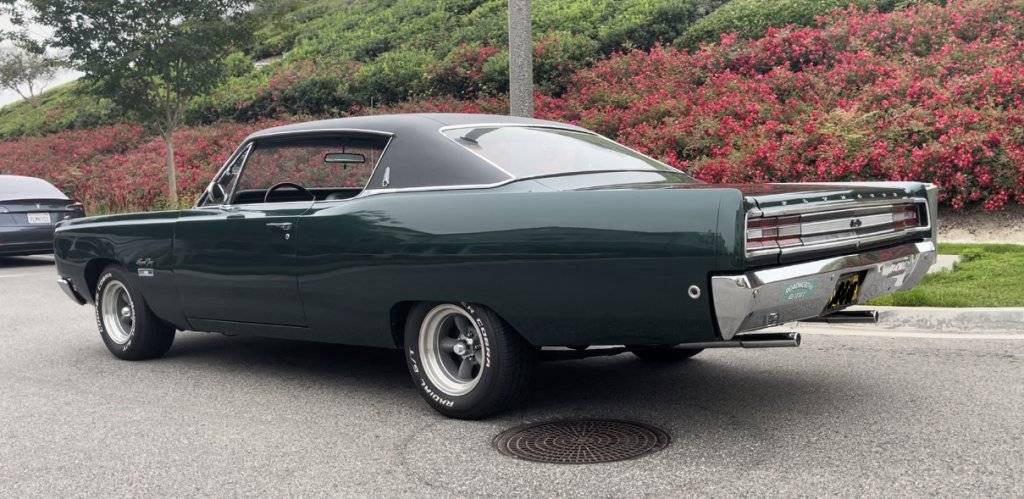

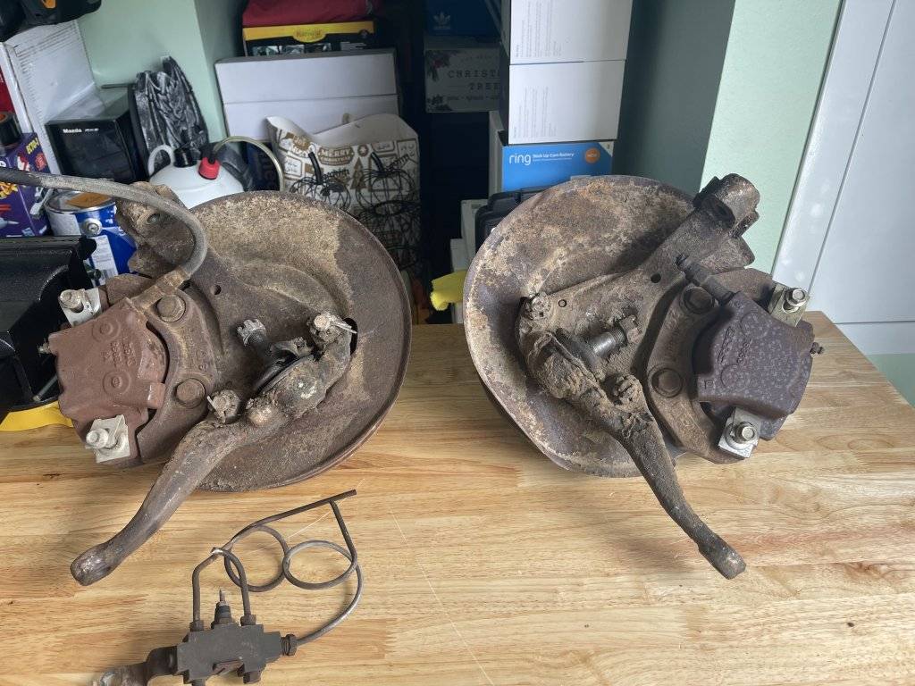

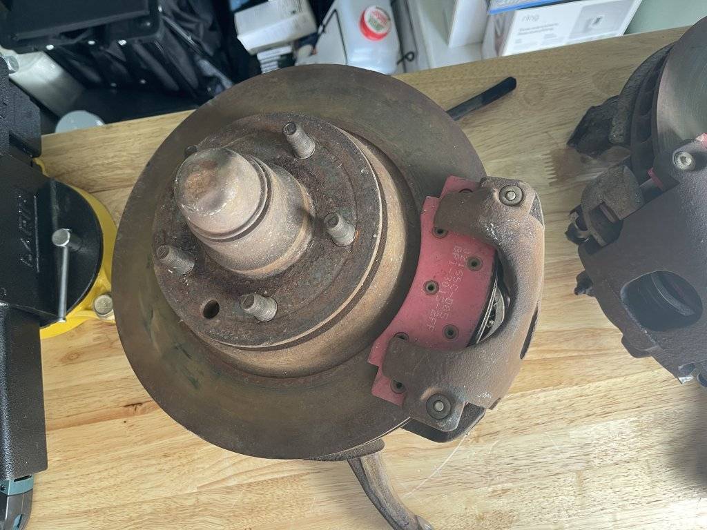

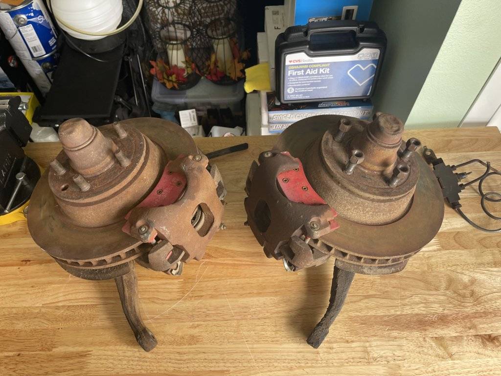

Scored a factory set of OEM C- body disc brakes pulled from what was left of a 69 Dodge Polara thanks to Desert Valley Auto in Black Canyon City AZ. I’m going to rebuild these and clean them up for my 68 Plymouth Sport Fury.
Includes the spindles, wide mouth Kelsey Hayes single piston calipers, caliper brackets, inch and 1/4 thick rotors, dust shields, and prop valve.
In addition to, I’ll be buying the correct rebuild kit for the c body calipers, A2, A6 bearings, hoses, Bendix Booster, and a mopar disc/drum MC with 1’ and 1/8 bore.
