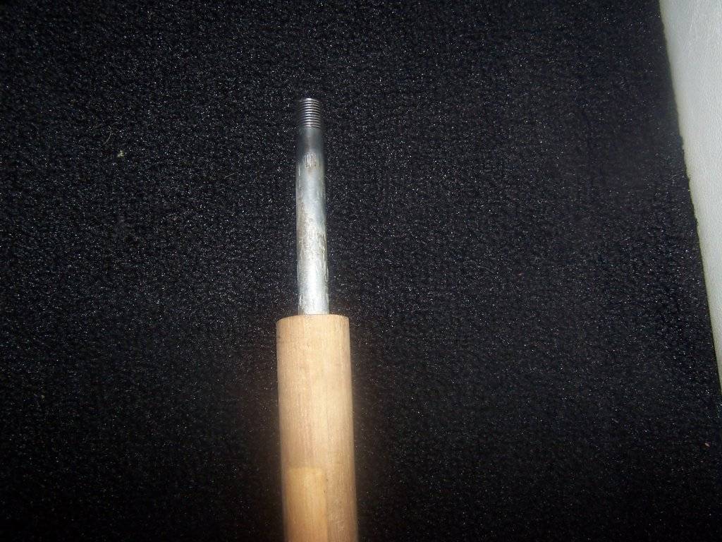

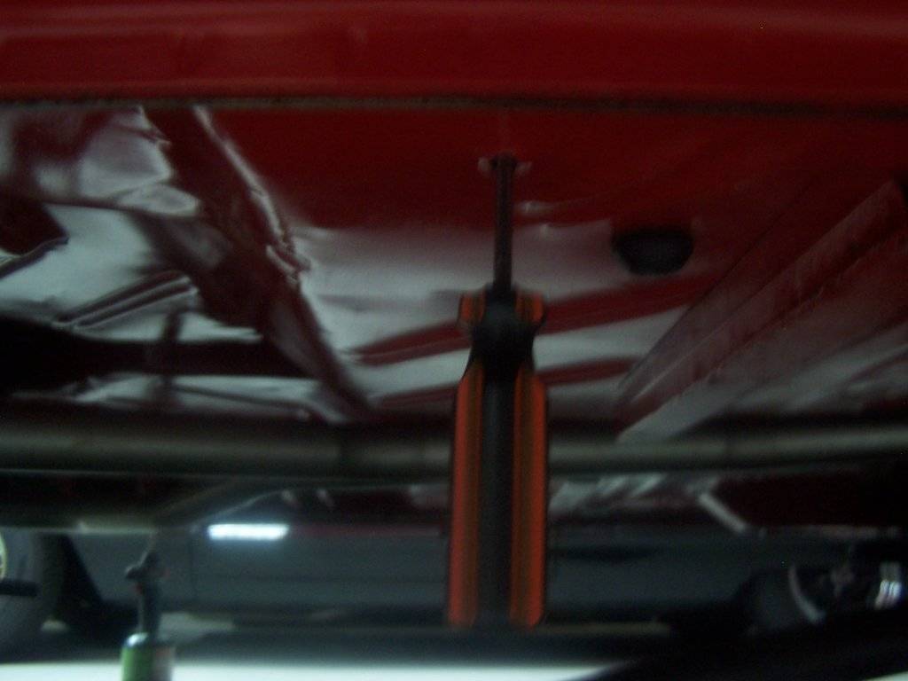

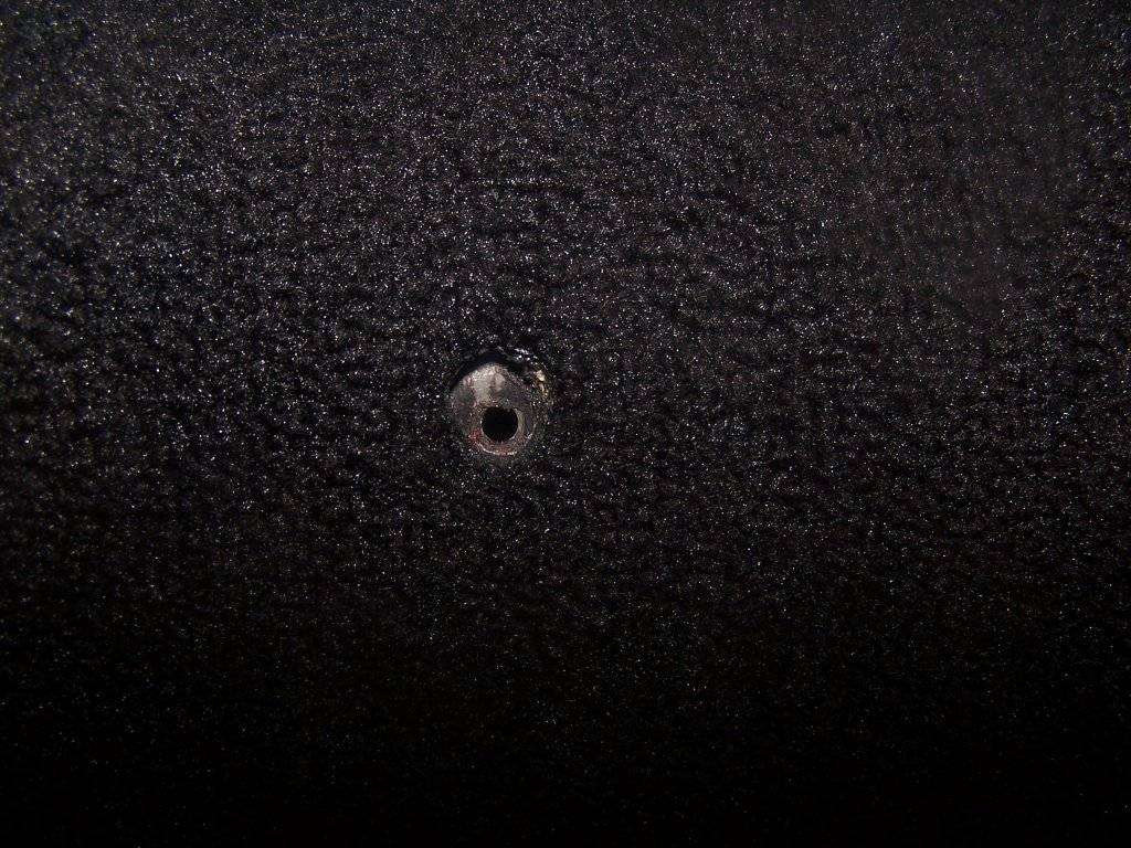

I believe they were an option already in 57 but few cars got them. My 60 Dart did not have belts but the mounting spots were provided. Not sure about 57 but here is what to look for. Under the floor pan, look for some dimples up in the hump and to the rear of the front seat. Here are some pics of where mine were and what they look like. I only added the front belts but I did look for the dimples for the rear belts. I found the outer rear dimples in the wheel wells and the inner ones under the rear seat.

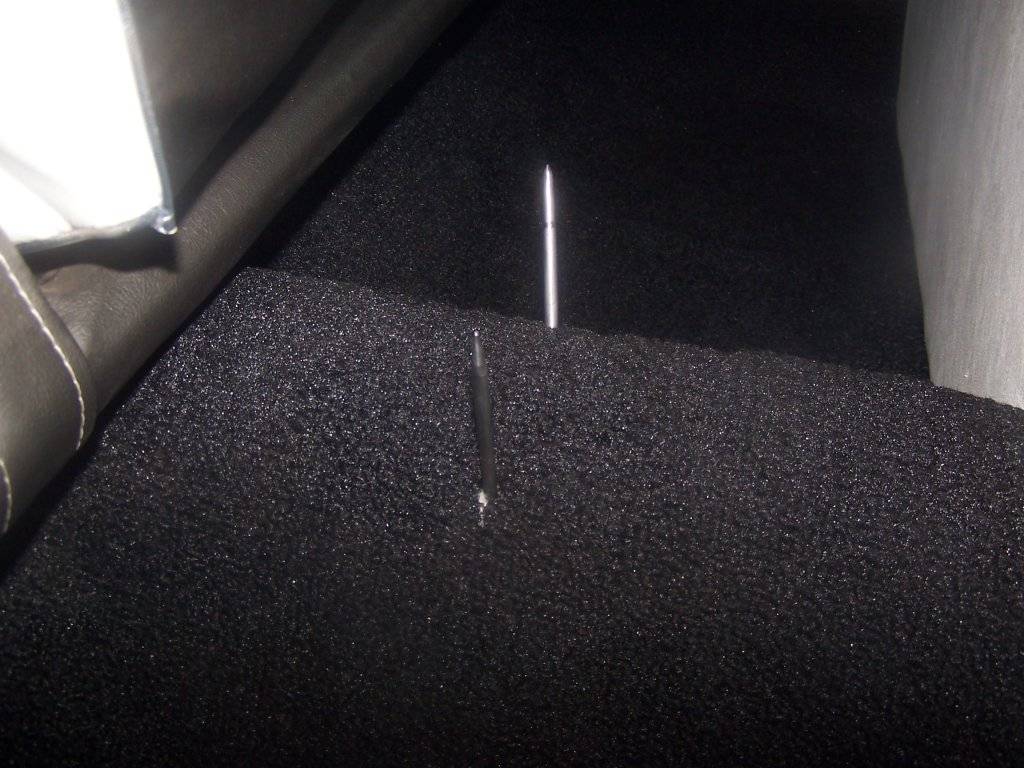

Here is another tip....If you already have the carpet installed, you don't want to drill a hole thru the carpet. What I did was drill a 1/4" hole in the dimple from underneath. Push a scratch awl up through the carpet then heat up a length of 1/4" pipe to melt a 5/8" hole in the carpet.
Then drill the 9/16" hole for the anchor. Here are some more pics.
Hope it helps.

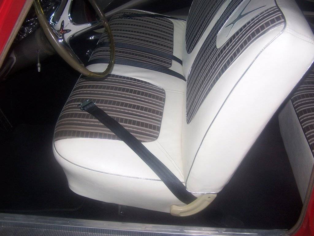

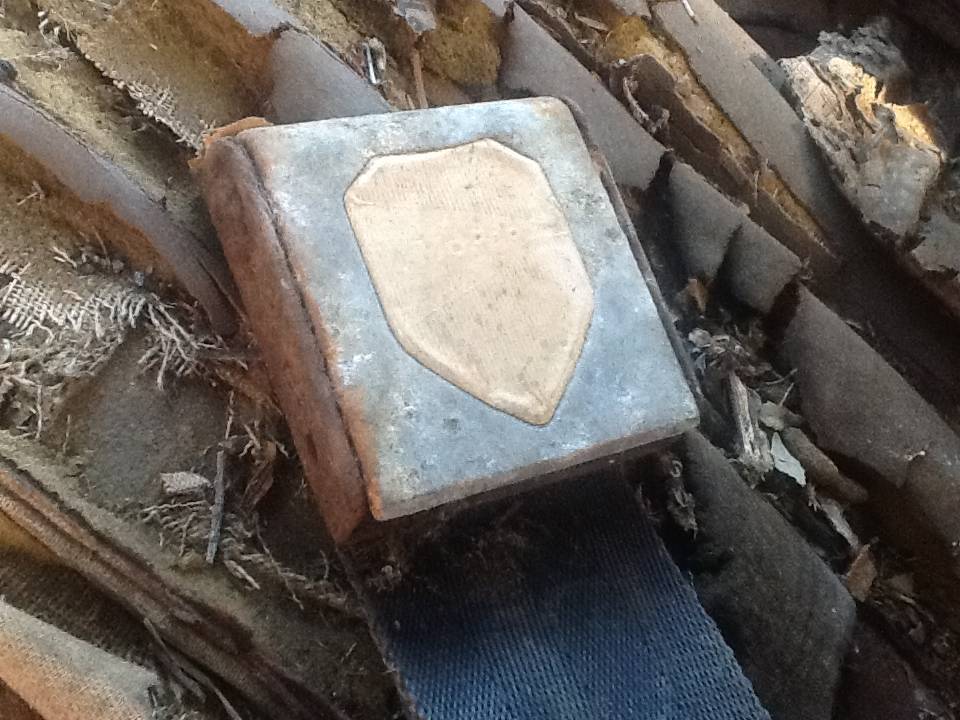

I have a 61 Fury that has factory installed seat belts.
This is what they look like for 61.
Mopar logo inside the gold shield.
A VERY rare option for standard production passenger cars in 61.

If I were installing belts in a non belted car I would use the mounting hardware from a 62-64 Chryslers
I got these belts out of a 1955 Buick. I think a dealer installed belt. I will be using these in one of my 61s. Yes I know they are old,but I would rather have them than nothing at all.
SGT Fury
I hope you are planning to get your can get your belts re-webbed. Looking at the pics, they appear to be frayed.
The original labels can be reused if desired. They can either be sent out to a seat belt vendor (Seat Belt Planet www.seatbeltplanet.com, (a veteran owned company), Retro Belt www.retrobelt.com these are two that I know of.)
A trivia piece of knowledge; according to my upholstery guy, there are only two manufactures of seat belt webbing. Both are in Europe.

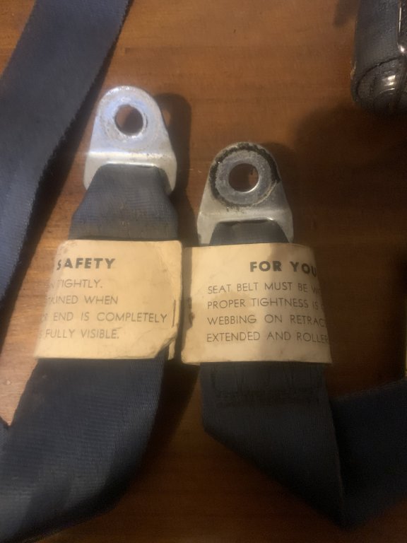

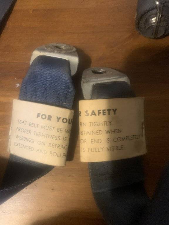

While on the subject of seat belts. I got these belts from a 66 Newport. They must have fallen under rear seats when new?
Still had these factory seat belt operating instructions on them.
Anybody ever seen these instructions before?

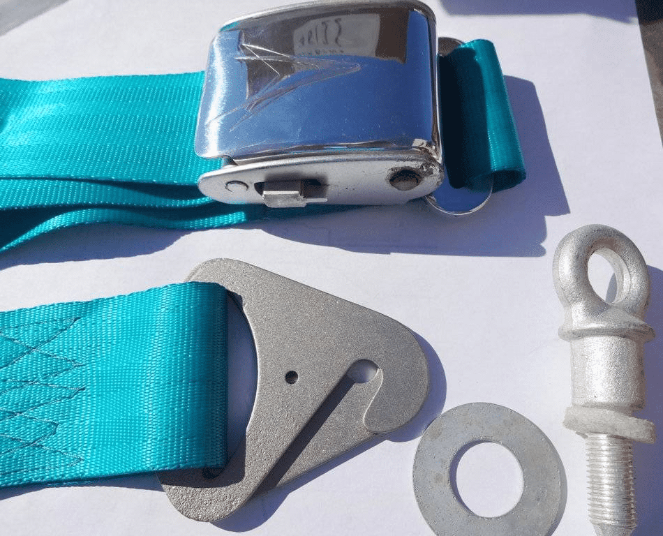

Belts for your 57 were only available through the factory accessory book over the counter. Placement is where ever is comfortable for you.
Originals had a bolt with a loop in the floor with a large washer on the underside. The belt attached with a forged clip.
This is a example of a original OEM seat belt including NOS mounting hardware. The correct belt material is called (7 panel). Look close at it.
The webbing material is usually available on ebay in many colors although all originals were a tan/brown color.
