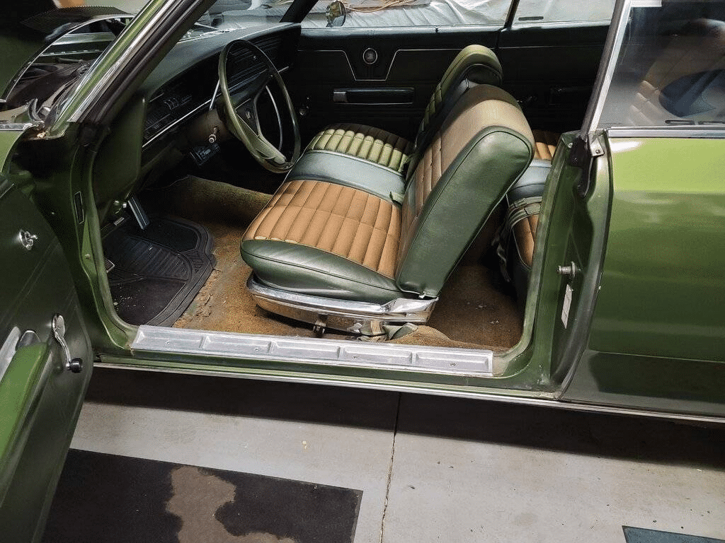

Here goes a picture that shows the slot on the 69 where the belt retracts.
Thanks, both of you. I didn't have any idea so I installed the carpet the bolted the retractors on top.
Think I'll just make a carpet box to sit over them. Maybe the cardboard was to shape the carpet over them.

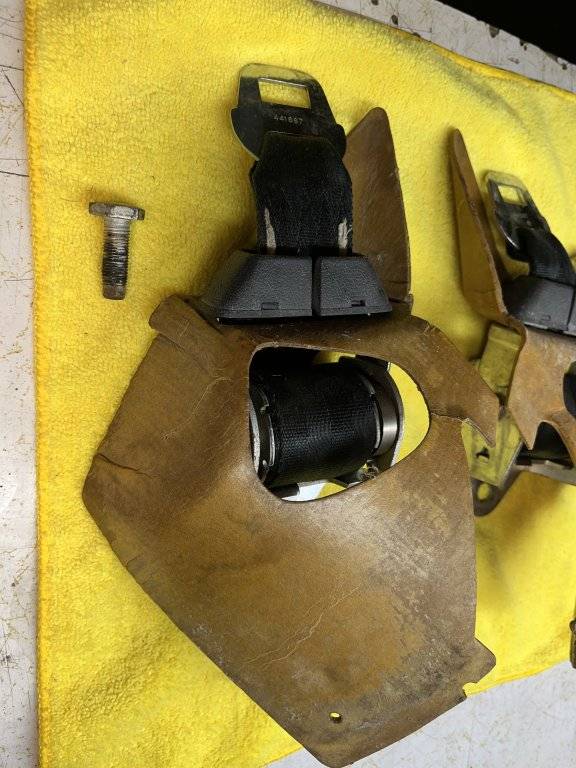

I have the plastic guides on the retractor.
Here are a few pictures of 1969 Plymouth Sport Fury convertible seat belt assemblies including the belt retractor , belt guide, cardboard hump and mount bolts. These belt assemblies were used across the Chrysler, Dodge Plymouth c bodies in 1969 . I had this set on a shelf in my garage just in case there needed.
