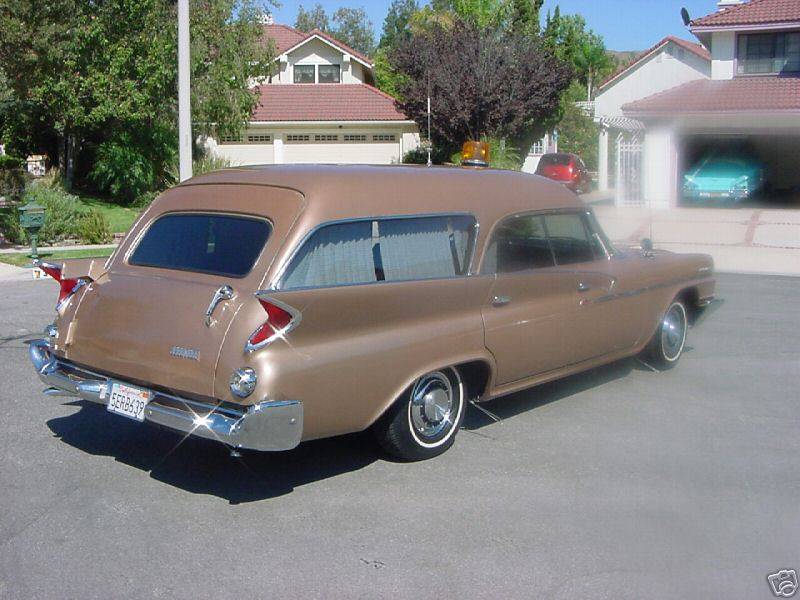

Thanks for the pictures! Nice looking car. Wondering if the 2nd row seat deal might have been a "fleet option" rather than a "consumer option", as there would be no need for 3rd seat access on an ambulance?
Several years ago, at Mopar Nats, there was a '62 New Yorker Sheriff's car. It was converted to allow a gurney on the passenger side of the SEDAN. Needed the longer New Yorker wheelbase/body to do that, I suspect. It was fully fitted-out with the nurse riding on the driver's side of the rear seat (what was left of it) as the front seat (rh side) was not there, either. Had the gurney in place, too. A nice restoration of an interesting car, from a time when the Sheriff would do first aid "in the field". Sheriff/Coroner/Medical Examiner/Ambulance Driver. Complete with the black doctor's bag.
That particular car was silver with a Sheriff's dept logo on the front doors. I've got some print pictures of it, somewhere.
