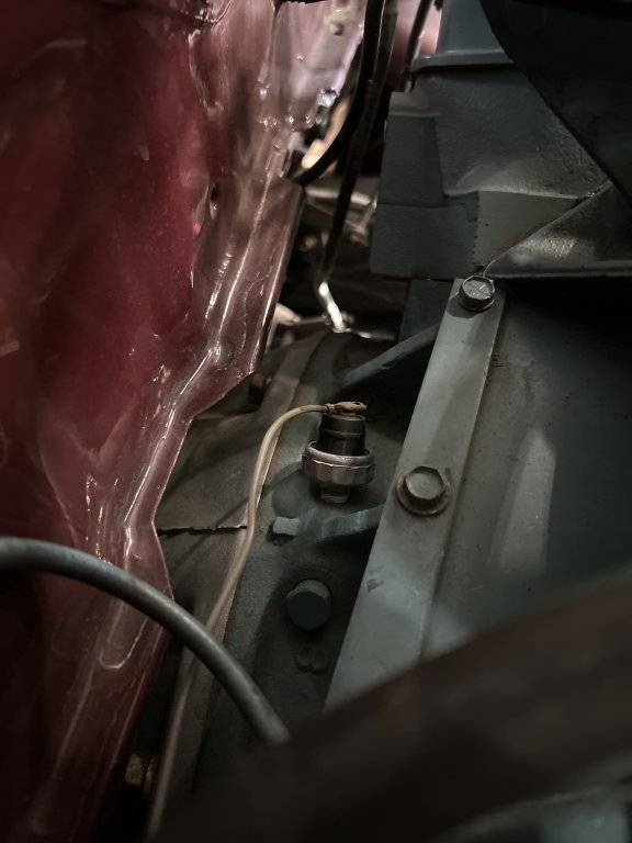

My 68 300 with 440 is back of block close to the firewall. Hard to see, angled towards driver side. I think all 440's the same.
Back behind the air cleaner and intake right before the bell housing on the top of the engine.
I kind of wondered if that could be done by removing other plug, I thought about that with mine, have 2 seperate monitors.
Yes, that opens right into the same oil passage. I think it was there so the oil passage between the left and right oil galley could be drilled during production.

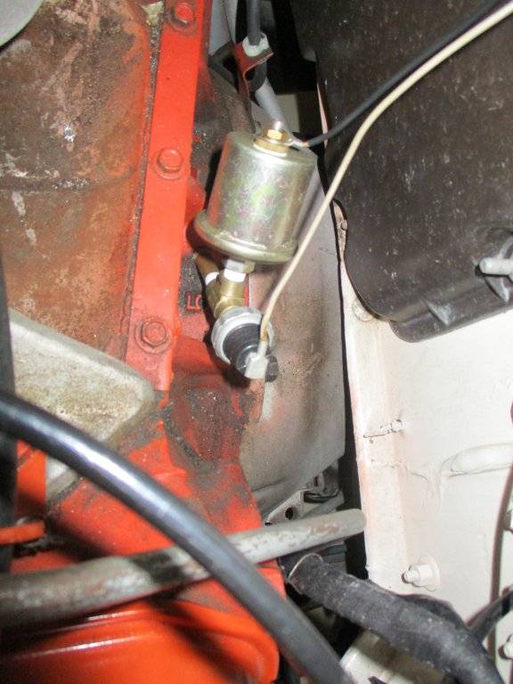

And you can make a tee at that location if you want to use the dash oil light AND a pressure gage (the large shiny unit). Piping connections are at any hardware store.
Just be aware. The mass of the sensors may cause the fittings to break. I had a nipple break and I suspect that the part was chinesium brass…
As the Imperials had a "Master Gauge" light plus an oil pressure gauge on the dash, there might be TWO units on the block for such. The shorter one in the image is for a light. The larger, bell-shaped one is for a gauge. Perhaps a FSM indicates how the Imperial items mount back there? Using the same hole or both holes? I concur about the weight of the combined items in one brass fitting possibly causing fatigue issues of the soft brass.
Indeed, you certainly don't want a tall "tree" of piping vibrating and the fracturing. Keep 'em short as possible.
Fortunately, I have a bunch of 1/8th NPT nipples and fittings from the early 80's....definitely not Chinesium.
