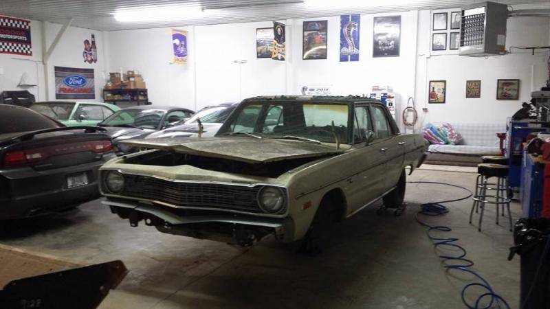

My A-body needs a new under hood and dash harness. I have a same year A-body but it has factory AC. Am I better off to source a non AC harness for my build or continue pulling the AC harness? I can't image that there will be a whole lot of difference.
and before Stan says it, yes I have the FSM.....and no it is not here at the house with me.
the donor car has a very clean harness without a single cut wire and it's in really good shape.
heres a photo since everyone likes photos.....

They are both 74 dodge darts. Only difference is the two door I am fixing up was a slant six three speed, non AC car. The donor car is a four door V8, auto, AC car. But I am turning the two door into a big block, auto car. So the difference is AC and obviously some wires will need to be altered for the big block. But, I did notice they both had the same voltage regulator and the good V8 harness has electronic ignition which will be carried over. I did notice that the donor car had wires to the blower motor on the engine side where as the non AC car did not. Also, the donor car has a three speed wiper motor, but I will just move that with the car as well. I will have to see if the blower motor can be swapped over too, if I bother with the HVAC since it's a big block swap. Most of the dash out of the donor car is getting swapped over as well since it's in much nicer condition. I just remembered, I need to get the wiring going to the neutral safety switch on the auto as well.
