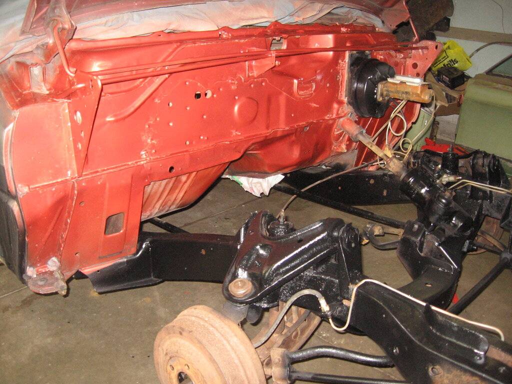

Me? I left my stub in but detailed everything while t he motor was out..
Alright. Yes that’s what I did too . Everything up to the firewall Is done . Was just wondering how to do the part that’s bolted to the chassis and how to reach on top of thatframe part .
