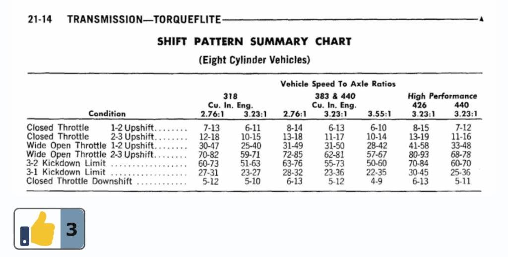

I recently had the transmission filter/fluid changed and the kickdown band adjustment set to specs. The manual lists the following shift points for my car. All numbers represent MPH.
Closed throttle (I assume that means an easy take off from a full stop)
1-2 gear 8-14 /15 2-3 13-18 /25
Wide open (I assume that means flooring it from a full stop)
1-2 gear 31-49 /35 2-3 72-85 /75
The bold numbers are where my car shifts. The “closed throttle” numbers
are slightly off. The “wide open” numbers are in range.
ALL shifts are very smooth and the kick down/passing gear works great.
My two questions are -
1) Does your car shift in ALL the correct shift point ranges?
2) Should I be concerned that my shift point numbers are slightly off for the “closed throttle” shift point ranges even if all shifts are smooth?
Thanks
