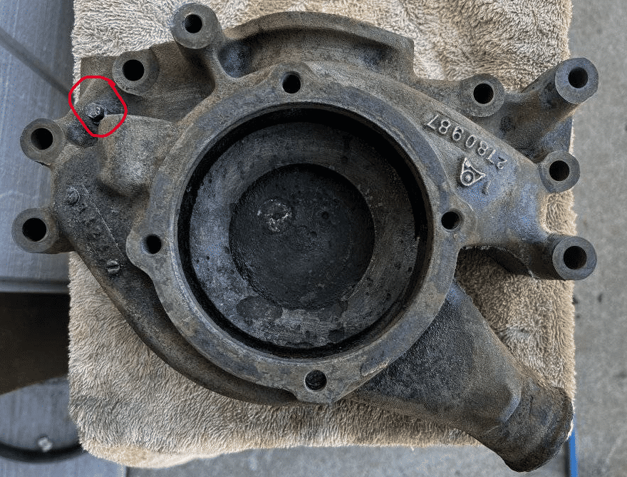

This is the stock housing that came on my New Yorker. Let me tell you, it was a PAIN to take apart. I’m talking about using the acetylene torch, breaker bars and drilling out 2 broken bolts…

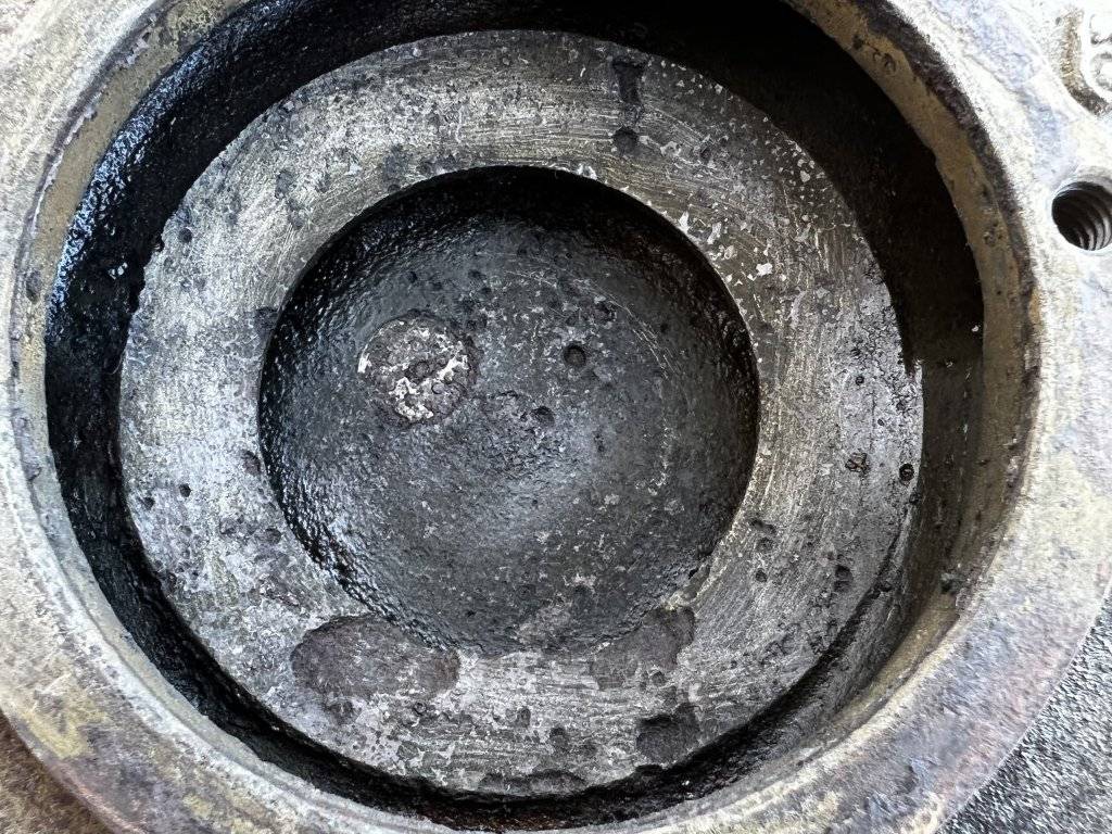

This is the water pump housing after letting it soak in citric acid for a day. I pressure washed it and wire brushed it and it’s coming back around. Inside the housing itself however, it looks like this.
It’s not flaking away or anything. After some more vigorous brushing and pressure washing, I’m going to once again let it soak for a day to eat up the rest of the rust. I am just wondering if the inside pitting is “bad” and if I should just look for another housing altogether…

Try finding another one in better shape. The pitting inside the chamber may reduce the flow and compromise the cooling efficiency. The heater pipes are available from eBay motors.
If that was a housing that was real rare and hard to find, I'd say that it would probably be OK... But! Since it shouldn't be too hard to find another, I'd replace it based on the internal pitting. I've never seen one that bad.
There are left and right lower hose versions, so be thoughtful of that when looking at replacements. Possibly some differences for the temperature gauge port too. That said, an identical one won't be that hard to find... Match the casting numbers.
That housing is junk with all the pitting and corrosion in the round circular area.
Look at a good one, that's a machined surface and I'll bet a reason why.
That big crater will do no good.

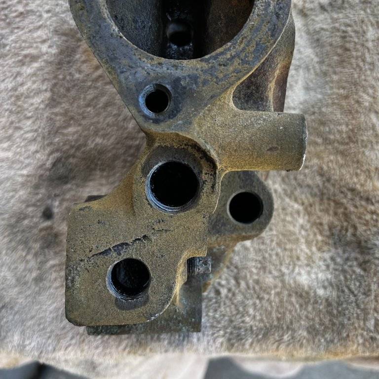

Thanks everyone for the good input! I DO have another housing, however it’s for a later big block. The heater pipes are different
Stock water pump housing
1970+ housing

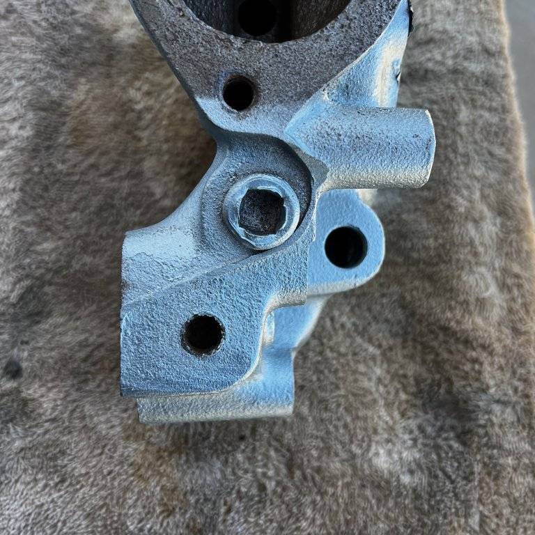

One of the heater pipes is still a 5/8, but the other is like 1/2. I didn’t realize this when I bout the unit over 2 years ago on eBay. Also, whomever sold it to me (I don’t remember) must’ve broken the heater pipe trying to remove it, because it’s stuck real good in there! I guess we will try to move forward and very carefully remove it.
Is there a specific fitting I might be able to use as some sort of adapter?
Because of the broken pipe inside and the pipes being different diameters, I figured maybe it was worth a shot to try and save the original housing! Good thing I checked here first

It’s junk, replace it. You will need a 1967-1969 housing. The 1966 and older have the different sending unit placement and cast in stand for the alternator bracket in a different Place.
the 1970 and newer have the smallEd heater hose hole.

I would not use that housing. It should not be that hard to find a good used replacement. Or you could drill and tap the heater hose pipe like mentioned above and use the newer one.

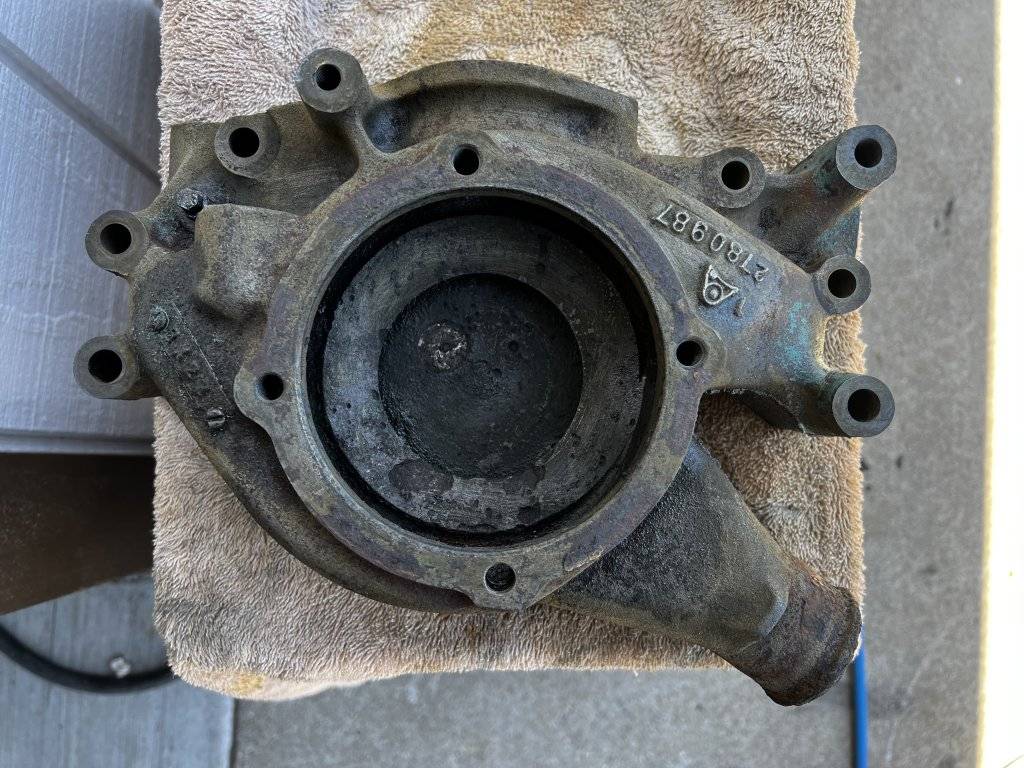

For fun, I let the housing soak for another day in the citric acid. I scrubbed vigorously and cleaned all the threads before I put it back in the acid. I wanted to see how well it could come back. Didn’t look too bad!
