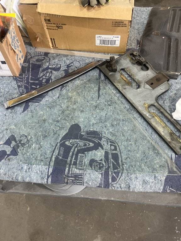

I have a 1966 Newport

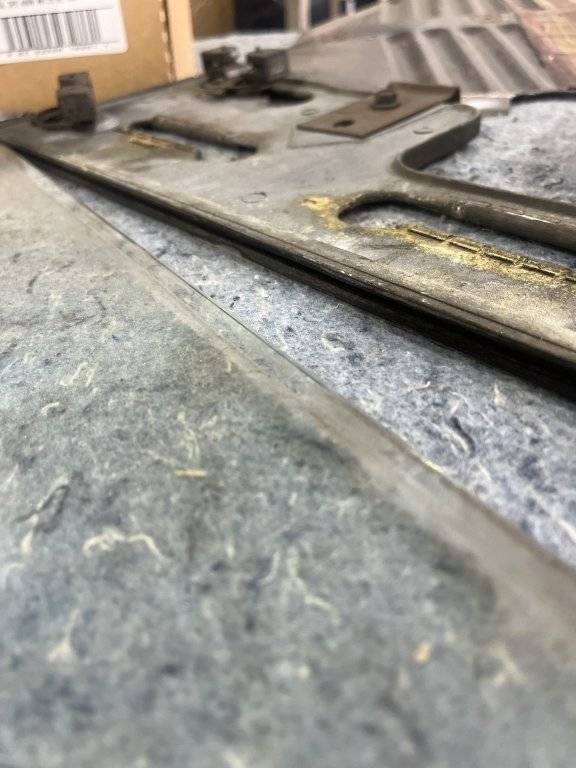

The glass came loose from the frame on my left rear window
The rubber is still in the frame and appears to be in decent shape
What is the best adhesive to use to glue the window back into the frame?
Any suggestions would be helpful
Thanks
I suspect that if you look in the FSM, it might not mention any adhesive per se. "Glass tape" was used do wedge and adhere to the glass and regulator channel. That is probably the "rubber" you see in there. If you use any "adhesive", this could be the last time that glass might be installed into the regulator.
Unless you install new "glass tape" in the channel, you might use a thin layer of windshield urethane for lube and adhesion?
Just some thoughts,

After posting I looked up generic ways to do that and that’s exactly what they said to use a rubber tape
Just came back from Summit Racing. I live near Akron Ohio
Gotta roll that rubber tape
That makes perfect sense the way that it is installed
One says to use kerosene to lube that for installation
and that makes perfect sense also
Thank you very much for your input. I appreciate it.

Yeah, not kerosene on the Glass side just on the channel side

I just did this on my 67 Imperial HT. used the 1/32 inch tape from Restoration Specialties. I had to first clean out the channel. It had hardened tape / rubber. I scraped it out with a razor blade and then used acetone to clean the channel. Worked fine. You can find good videos on Utube.
I guess the question should’ve been does anyone know if a 1966 Newport two door quarter glass and a 1966 convertible quarter glass are the same
