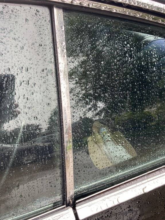

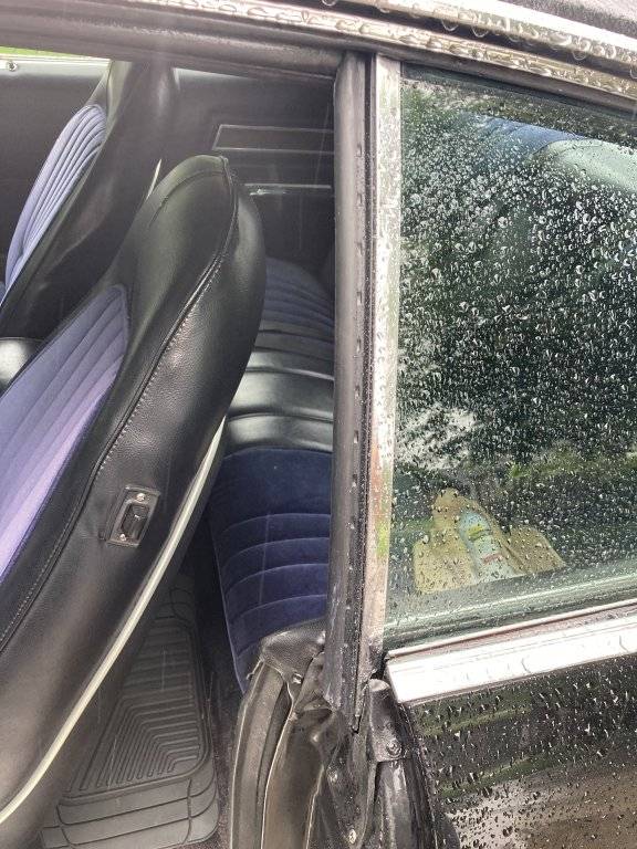

As my vertical side window weather strips - between front and rear door glass - are torn somewhat, I would like to find "new" ones for better sealing.
Couldn´t find anything for my 73 Imperial yet.
Steele Rubber doesn´t offer that for Mopar C-bodies and I didn´t find them mentioned for 71-73 models by searching on FCBO - has anybody a lead or maybe some thought, which weather stripping from another car can be used?
Many thanks in advance!

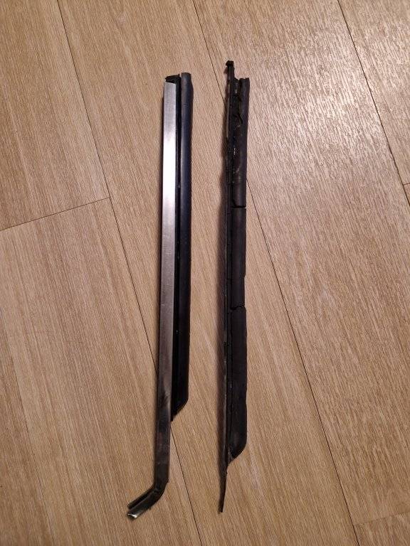

I suspect that almost all of those weatherstrips are more universal in their style and design than might be suspected. Which means that something from GM might work, too. Just match the main vertical length area. The small screw at the bottom is mostly there for show as the weatherstrips fit very snugly into the chrome channel. Even if you might find something longer, it can be trimmed at the top, I suspect. There is a metal reinforcement inside of the rubber, on the "chrome side" of the item, too.
JUST some speculation,
CBODY67
It was the same "quarter window seal" for all '69 to '73 4 door hardtops. The same profile was used on seventies A-bodies and B-bodies, too, and quite possibly also on '65- to '68 C-bodies and B-bodies.
The best alternative to OEM set is the Metro Seal VS7-AFL. It lacks the metal insert at the bottom end, but otherwise it's the same profile. I found this by trial-and-error method when I searched for new seals for my '70 4-door. I bought 5 different sets. VS7-AFL met my criteria:

Metro VS 7-M are too short.
