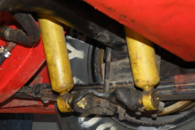

Here's a similar set up I'll be attempting. I have lowering blocks to use and want to keep OEM u bolts. I think the 8 5/8 size will work.
I found a set of 4, part #3402180, NOS, 8 5/8" u bolts (aka "clips") and they are in transit. THANKS for the part number. Helped tremendously! Also scored the correct, NOS nuts for it.
