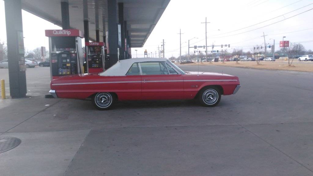

I installed them because the coil over shocks rode like a tank and leaked like a sieve.
I wanted a rake and I wanted to control that.
The more I drove the car the more I realized the springs were likely shot and the bushings are toast. They're not broken that I can see but they squeak and rattle like a bad bed frame.
As soon as I get the interior stabilized, I'll order a 2 inch arched set from Eaton, who was the OE supplier. They come with new fasteners and bushings and that's about a grand to my door + install.
I just topped off the tank about 20 minutes ago.
She sets good and the ride is smooth but squeaky.

This weekend I made a mature decision to do a "restorvation" on the convertible. This would involve restoring or replacing the worn and broken parts, while preserving the structure and outward appearance of the car as is, simply for both aesthetics and budget After 53+ years, the rubber noise pads between the leaves are gone and the springs ride against each other, grinding into themselves. So fresh springs with 20-50 lbs in the air shocks would allow the trunk to be filled without letting the car squat. And that's hardly abuse. Coil overs, which were the popular and only method in '66 would place as much as much if not more stress on the mounts.
2 inch springs with minimal air pressure and a loaded trunk would produce a slight rake. with the right rim 275 /60s or minimum 255/60s will fit.
