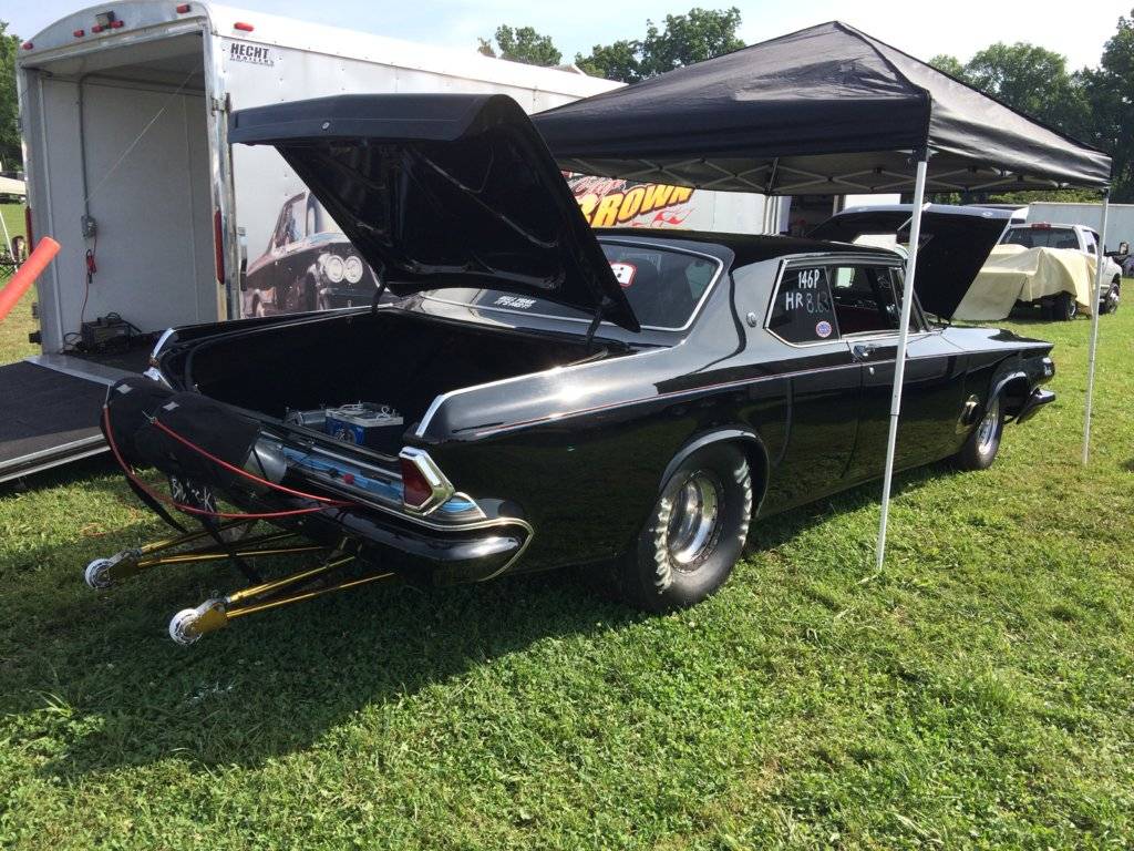

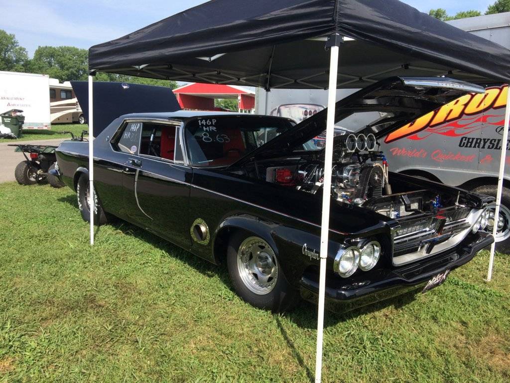

there quicker then they look , same engine well .
0yes , we were at the track sorting out our maxwedge car , and i just watched the rest of the feild run off , there was a 64 new yorker running a mild wedge , 440 or so . and that thing left better than ours and ran 12.5's all day , and he drove it there and home at the end of the day . just cork'd n put the street tires on , and away he went . so they can run good numbers as well . i've had some older friends that have watched the 62 300 h's run in the 11's back in the day . so have at it .
