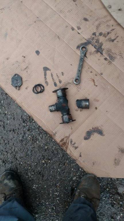

Was there any warning before it broke?
It has had a on and off vibration every now and again. So random it would be hard to pin point, so you wait for something to go bang, now you found it.
My friend that I am now indentured to for hanging around and getting me going and sacrificing a bolt off his truck to replace one of the bolts that holds the cap into the yoke. The threads are stripped too far in for the little short bolts that normally come with the joint.
So I spent my afternoon fixing and still made my backhaul load and with a couple of longer more correct bolts slipped in this weekend I will not miss a load keeping the truck owner/Mrs. Bigblockdodge happy.
