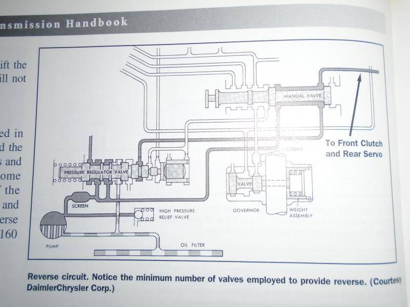

Okay you can ignore the band problem then, its time to look at the valve body. Oh, one other thing to check, make sure the selector lever on the gearbox that is bolted to the input shaft is tight, if it isn't, then it might not be selecting the gears properly.
Sounds more like a valve body issue. Could be a bad seal in the front clutch or worn out clutches. An air pressure test should determine whether the seals are bad or not. I doubt worn clutches. When I tore down my 727 the clutches where all warped and the friction plates where in pretty sorry shape, but amazingly they still worked! You could check your linkage adjustment but even with it being out of adjustment you should still get reverse if you try to wiggle the shifter back and forth and try placing it halfway between park and reverse or halfway between reverse and neutral.

He claims that low 1 works. If the band strut fell out or the band wasn't properly adjusted he would have no manual low but it would still go forward in breakaway low. The revers band is never used when the shift selector is in drive. Either way he has to drop the pan to find out.
Just did some rechecking and the overrunning clutch does in fact engage in low 1 if the reverse band is not applied. Turns out I was wrong after all. I still think its a valve body issue. If the band was out of adjustment he should have noticed it slipping before hand.
