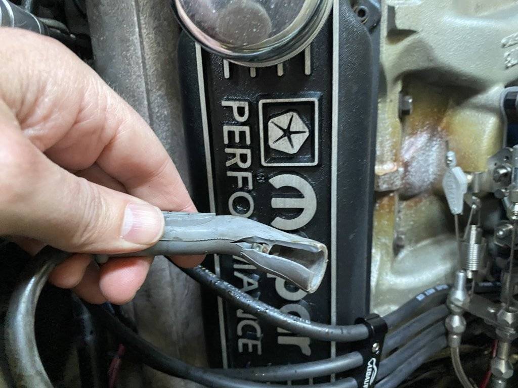

My car has been through a rough couple of weeks. Radiator replaced, alternator replaced, now getting to maintenance items and see the heat from the exhaust manifold has destroyed my spark plug wire boot (driver side, closest to the driver).
Any of you have luck with those heat shield socks they sell for this purpose? Figure with so many available on the market, and being relatively cheap, it seems like good insurance from this happening again…. But foolish if they don’t actually work.
