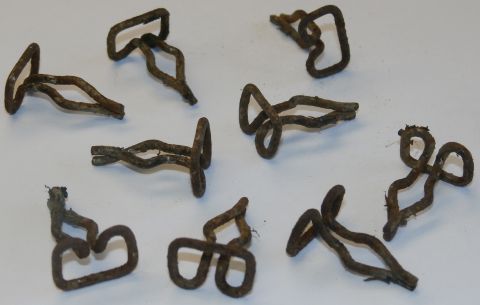

The original clips were made from spring steel. Clips for external, engine compartment, or undercarriage use were typically zinc coated although there may have been variations through the years and among suppliers. Clips used inside the car may have been uncoated. The following image shows some original clips with most of the coating intact. When the sacrificial coating is gone, the clips can rust although not as readily as mild steel does.
