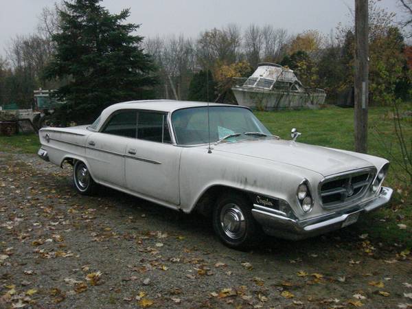

Hello, recently bought a 1962 Chrysler 300. She has a 383 with the push-button trans. Car starts and idles fine, But when put into drive stalls out. Does anyone have a idea what would cause this. Any help would be Great. Thanks

Big John has got you pointed in the right direction so welcome to the site from the Motor City! You added a picture without prompting so you're off to a good start, now tell us your story with it.

Great looking car. Welcome aboard. If you don`t have one get a FSM. As mentioned a brief history, plans and a few more pics would be great.
