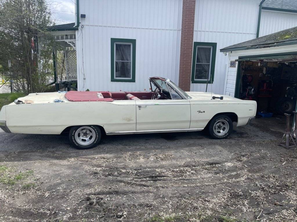

67 Fury III, 383 2 barrel
Problem at idle: fire up and run fine. Will sit and idle. Once up to temp, it stalls. It won’t start again until cool. Or if it does start, it doesn’t stay running. Even if pumping the gas.
Problem driving: if I fire up the car and drive it I can do 2 circuits of the neighborhood and it just dies, in almost the exact spot every time. Acts like out of fuel. If I pump the gas it just coughs and sputters , but still won’t stay running. Restarting is same as above. Best to let cool, then it fine.

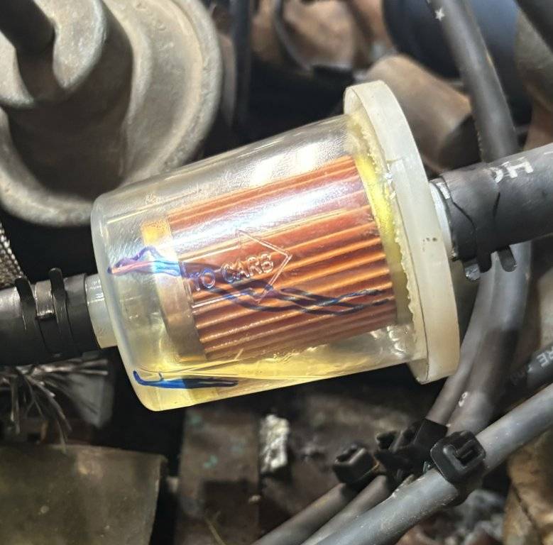

New fuel pump
Remanufactured carb
Rerouted fuel line and covered it in heat shielding
