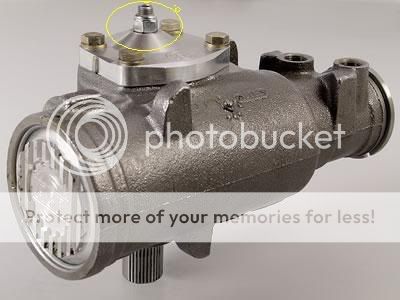

Has anyone done the adjustment.
My gear seems to have a bit of dead play in the center and I would like to tighten it up.
Anyone done this and what has been the experience?
usually uou just losen the nut holding the worm gear and use screwdriver to snug up the worm gear if worn..caution do not tighten to much..just snug it up a little...
belive mopar should be same type idea...may be wrong as well..just getting familiar with mopar setups
The mopar units are very similar yes but if the center adjustment doesnt have a screwdriver slot it will be a hex head. If the adjusting doesnt fix the vagueness at center typically you will need to rebuild the box.
I gave it a slight turn tonight. no chance to test though. I'll give it a whirl tomorrow.
From my experience trying to do this, it doesn't seem to fix the slop on center. I just go to Steer & Gear to fix this problem and get a rebuilt unit. The only rebuilders I trust after some bad experiences elsewhere.
Thanks for the input. I'll have to budget for this if this doesn't help it out. :)
I would leave it alone and replace it when you have the funds available.
yup all yer after is worm gear..only thing that can go wrong there is over tightening and thatll put extra wear on worm gear...play with valves ect not good idea...you get to that point rebuild or replace
