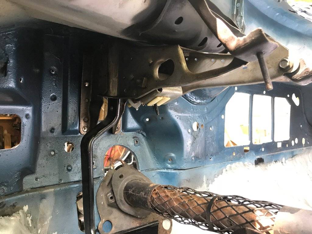

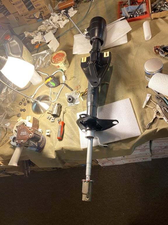

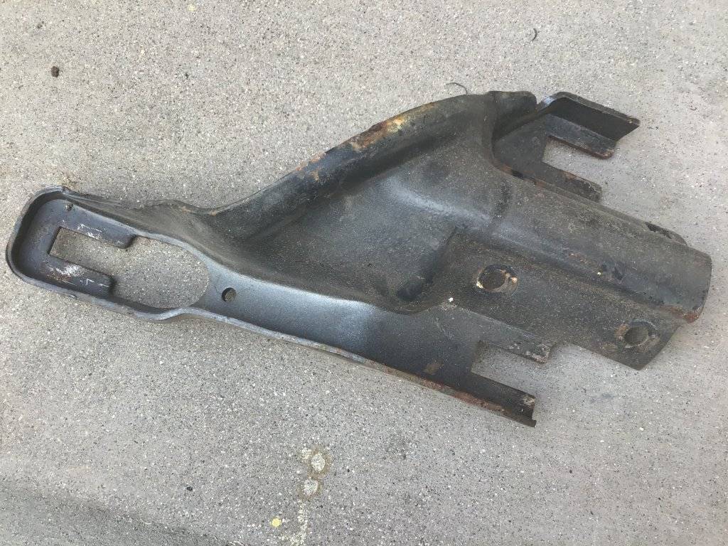

1970 Plymouth fury iii. Well I thought I took pictures of everything….guess not. I’ve got my interior almost back together. Went to put the steering column back up….cant remember how these go back in. Does anyone have pictures of theirs. Or able to help me? Thank you!!

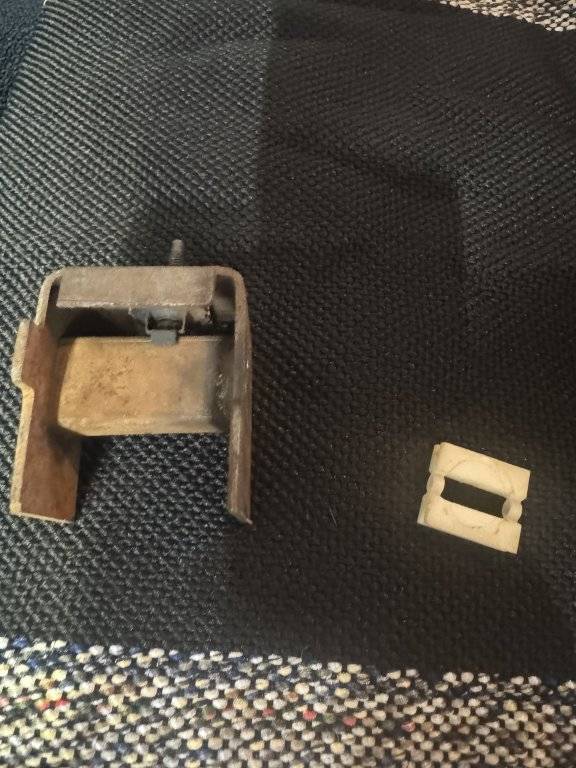

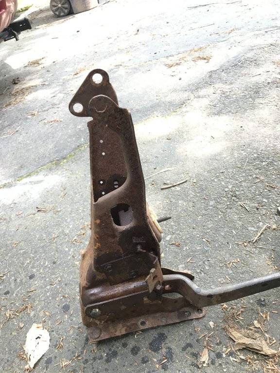

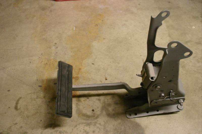

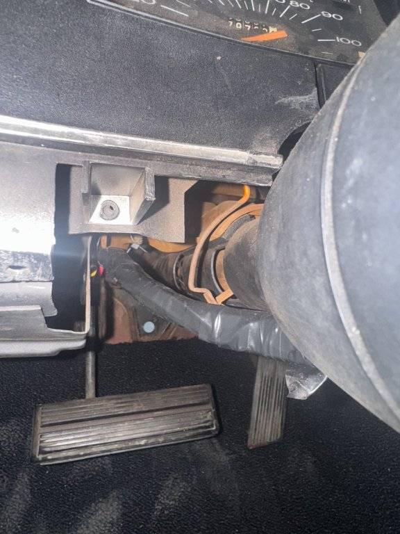

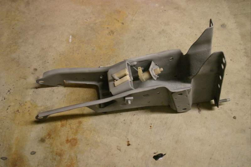

I think the metal bracket is part of the steering mount that goes on the brake pedal mount. There are actually three of those white plastic squares. You can just about see it in this profile view.
On all the other mopars I have seen those white plastic parts go on the bracket that bolts to the column, see the 3 slots for them? I know the 70 Fury has a rather large
Bracket bolted to the column, maybe it's different? There are dozens of folks with a 70 fury on here that should know.
