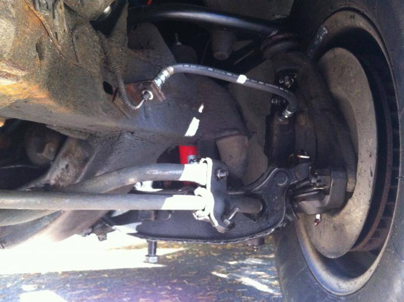

I've got a 66 TC wagon and the steering is overly sensitive IMO. I have power steering which increases that sensitivity even more - I can't feel the road at all. The steering responds with the slightest movement L/R of the steering wheel and is especially noticeable at freeway speeds. Around town at lower MPH it's fine, but getting up to freeway speeds 50-60mph it feels pretty scary as if the car could go out of control with the slightest movement from center. I feel like I'm driving on pins and needles needing to keep the steering wheel perfectly straight. All steering has a little bit of free-play, but the steering reponds even within the free-play limits.
Perhaps I'm just use to the manual steering and rack and pinion of my other P/S vehicles. Anyone experience this too? Is there an adjustment in the steering box to tighten my symptom up or is there something else going on here?
This was my dad's car - he got it in 1971. The car has 66K original miles. I just finished a front disc conversion using '73 spindles and CHANGED the UPPER BALL JOINTS, IDLER ARM AND TIE-RODS while I was at it. The lower ball joints were fine.
