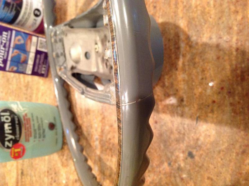

Started in on a series of small repairs on a steering wheel I thought might be of interest. It's the steering wheel from my 77 Seville but I've used the technique successfully on other steering wheels.
As you can see from the post above, it's a lot of sniggling little issues which include: separating inlay, cracks from shrinkage of the plastic, and general scratches. It will not be perfect but should me more than serviceable and a hell of a lot more comfortable.. Not to mention better looking.

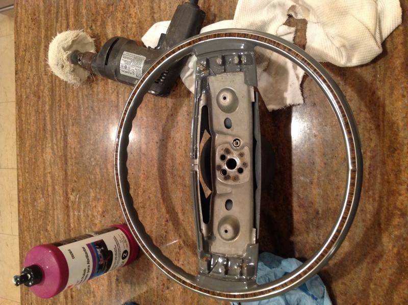

Here's the materials I am using:
Basic polishing compound and wax, clear acrylic epoxy, disposable squeeze bottles and fine glue tips for getting the epoxy into the cracks and behind the inlay. Not shown is a temp adjustable soldering iron and sand paper 220 and 400 grit.

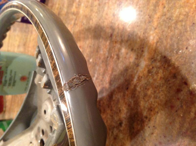

Using some of the flash ing from the original molding behind the horn pad, I cut slivers of the material an place it into the smaller cracks. Then using the soldering iron I weld in the slivers to be a little over the cracks.
It it may look bad now but not to worry. If you leave enough of the slivers protruding, (more than 1/16"), and your careful with the iron, the slivers will melt and fuse in the crack.
A little sanding, and here's the result.
After a little sanding. The crack disappears... Almost
A little more sanding and.....
A little more sanding tomorrow, some polishing and well see tomorrow how it turns out.

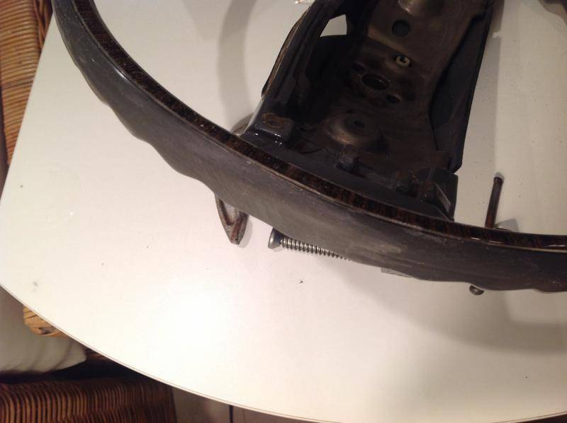

below is attached a view of the previous "repair" by others.
Commando 1.....I did it just for you. I thought I saw a crack in your wheel. But I could be wrong. This works great on all wheels.

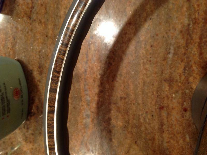

Here's the finished wheel. Two days of 400 grit then 1000 grit. Then polish like crazy, and.................
Not NOS, but cracks are gone, inlay is tight all around and the wheel is totally smooth.

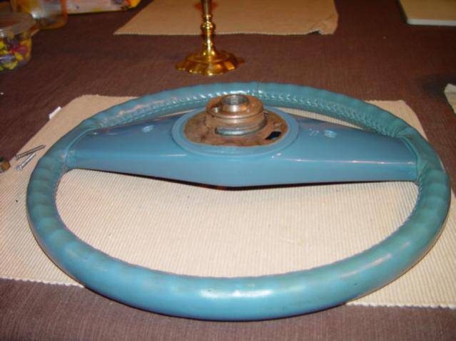

I cheated but the results were outstanding....
Before...
After.... 1977 Dodge Charger leather wrapped steering wheel and shaved 1/2" of the hub off on a lathe.
Installed.... one of none 1978 NYB with blue leather wrapped steering wheel.

I think a leather wrapped steering wheel from an R-Body will work too....with cutting the hub down a 1/2" like I did on the Charger steering wheel.
