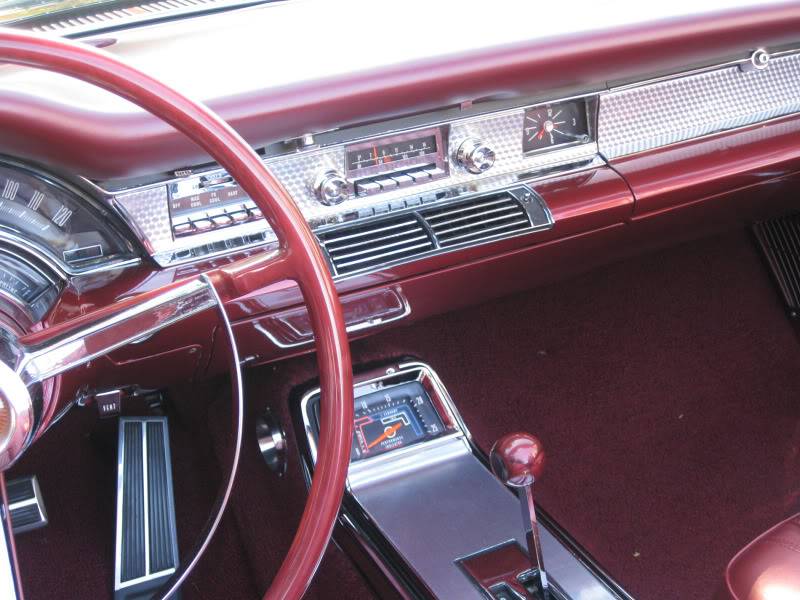

My original steering wheel for my ‘68 Polara was totally sun baked and cracked. I found a NOS new one on EBay around 10 years ago. The problem was that it was brown instead of maroon. I had the shop that did my body work and paint. Do my steering wheel as well. It turned out beautiful and had the proper tone(not glossy).
However after a season of driving about 2000 miles, the oils from my hands is taking the clear coat off.
I have never seen a NOS maroon/ Burgundy wheel so I need to make this one work.
Any suggestions on a durable finish? I am going to talk to the shop that painted it, but not sure they normally paint a lot of steering wheels.
First picture before a lot of use. Kind of a matte finish. (Except towards the top where you can see it start to wear off.
Now shiny where the clear is rubbing off.
Thank You

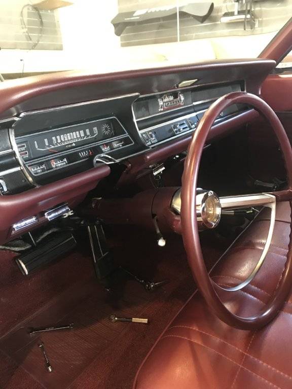

They can cast it in whatever color you want. The color is added to the resin. I had my wheel and shift knob recast. They came out perfect and are just like they were originally.
Before:
After
