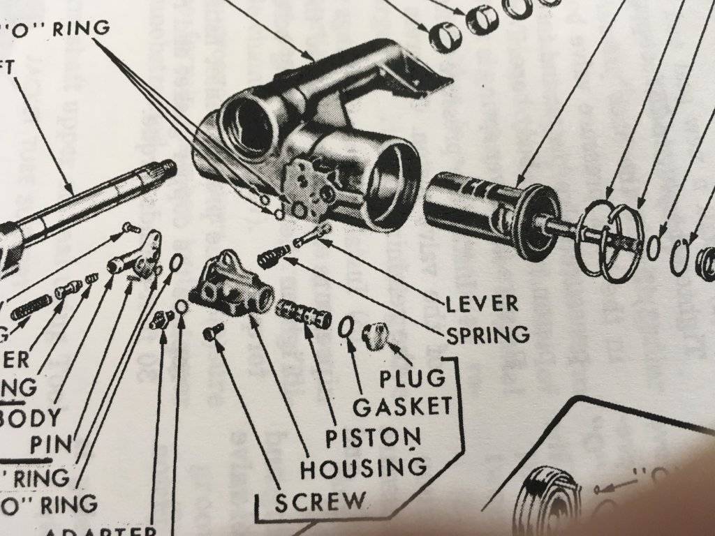

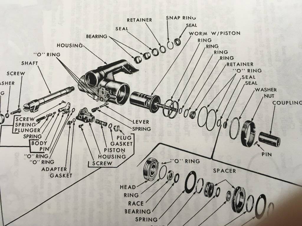

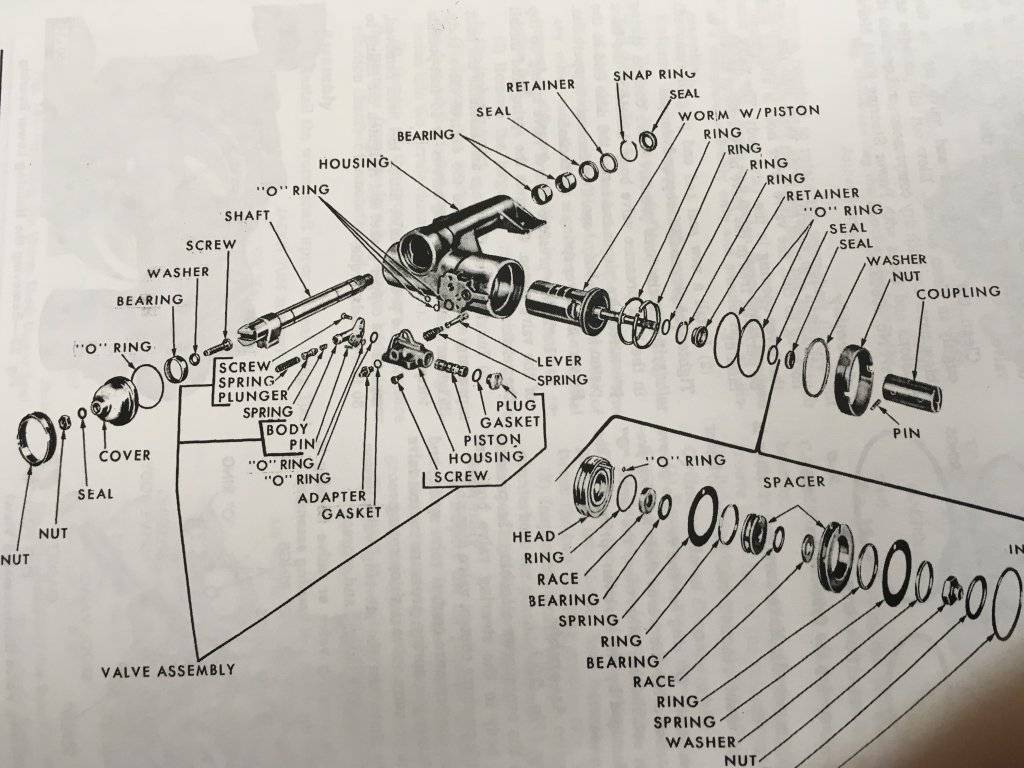

I vaguely recall that if you take the valve body off the steering gear that you will get this problem unless you putz with it during re-assembly? In this case, I did not remove the valve body.

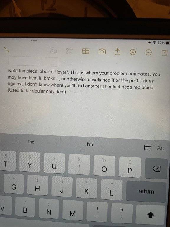

That does sound like the valve body is off. That is the only cause I've seen.
You removed and replaced the engine, correct? It's not out of possibility that the valve body got a little knock by a swinging engine. It happens.
Lots of threads on the subject here. I've never had to adjust one, so I'm not the guy to advise on that.
Adjustment procedure is covered in the USA C/D/P factory service manuals. Takes a bit of time, unfortunately, but done once is all it has to be done. Not a model-year-specific item.
