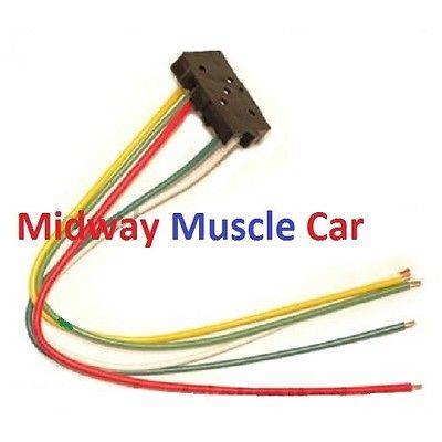

Looking for a single power window switch connector for a 65-68 C body. Other makes and models should also work. It’s for a single switch. Looks similar to the picture

And the PW connector would be the same for all 1965 - 1968 MoPars, EXCEPT Imperial and 1965 B body.

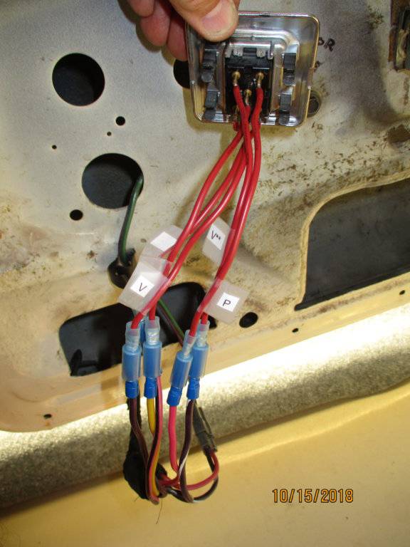

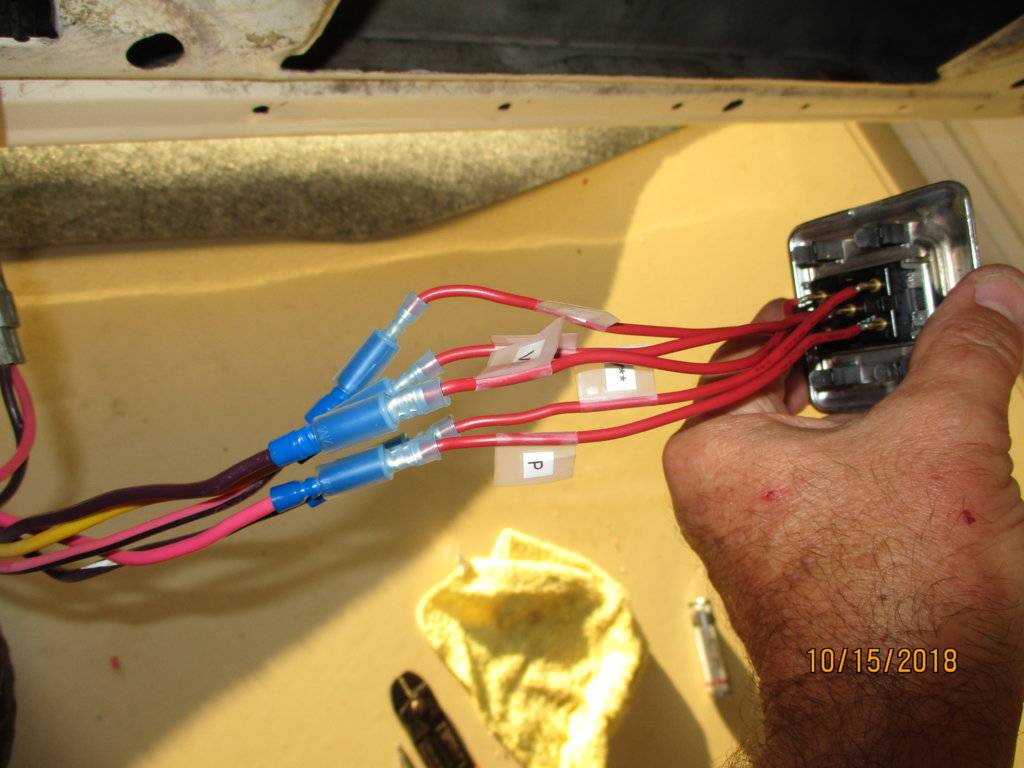

I posted a connector fix in this thread a few weeks ago, post #8: repro window switches
Basically, I tossed that problematic connector and "pigtailed" my switch, which I explain in that post. Window suddenly worked like a charm instead of a slow....slow....slow....creep.....stop an inch from the top.
