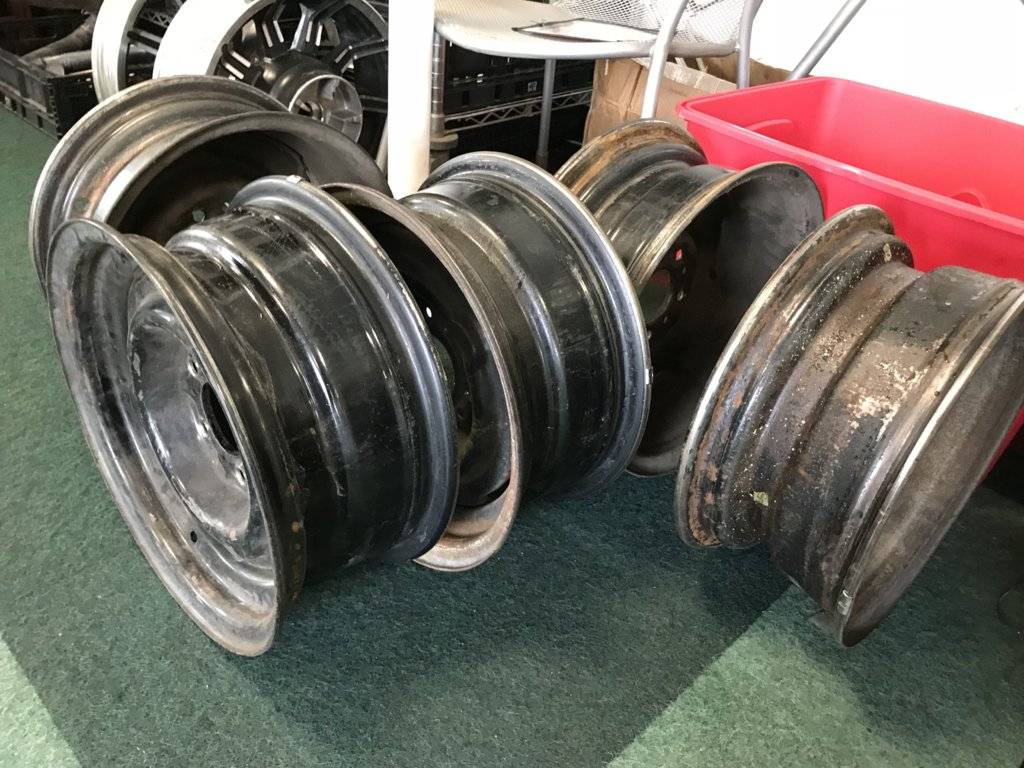

Having hard time finding stock tire size for 65 NYer wagon. It has mopar non-stock tires on oversized rims. I do have a set of 14 inch rims off a parts car 65 NYer sedan. Thanks for any info.

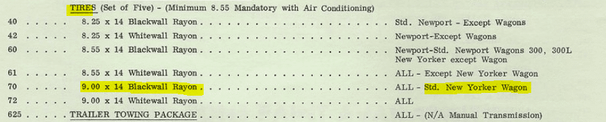

Arthur
8:55x14. no comparable 14 inch exists anymore.They were close to 29 inches tall. I have a couple NOS originals from 1970 just for comparison when I replace them. 15's are your only decent choice to stay close to original.

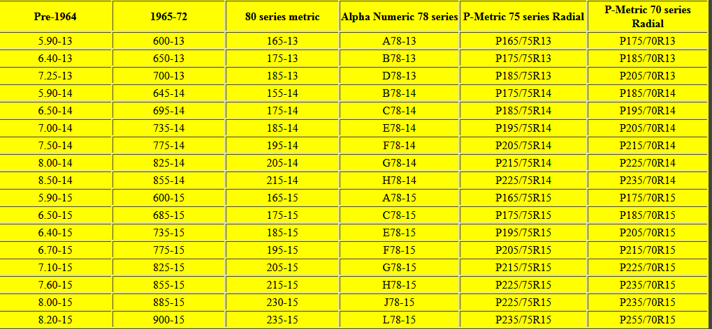

This is from www.hamtramck-historical.com
Coker Tire
This chart doesn't show the 9.00 x 15 but but not the 14. Based on other 14 to 15 conversions, it would be P235/75R14 or P255/70R14 but I can't find either of these sizes anywhere.

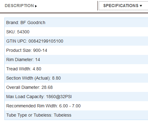

9.00x14 on 14x6.5" wheels.
The best long-term situation would be with some 15x6 wheels, P225/75R-15 tires, and Chrysler 15" wheel covers. The power disc brake cars in '66 used 15" wheels to clear the brake calipers. Otherwise, the Coker BFG 1" whitewall 9.00x14 repro tires would be the best option, from size and cosmetics.

I have 5 new hankooks sitting in the garage for my ‘65 Fury III wagon and the original 14” wheels at the sandblaster/powder coater.
Don’t be afraid of them.
