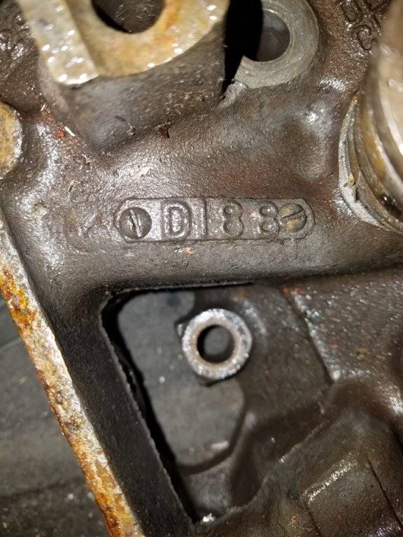

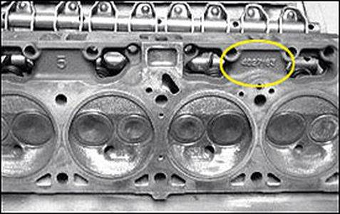

Get the casting date, it's on the other port, just like casting number. I believe they are around 71-72 before the 346 casting heads. IIRC
They may also be old cast iron stage V heads.

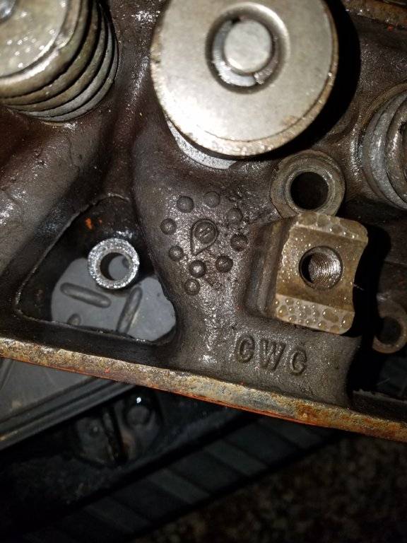

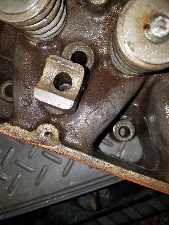

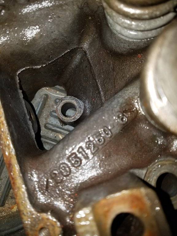

Here are all the markings on the heads.
I wonder why they made this head different to the regular 906's?
I have no idea and I don't really want to pull the 906 off the 440 in this weather to compare the bowl area. I'll compare it to a set of 452's I have in my garage tomorrow though.
Here's my gut suspicion . . . the only thing that changed with the 906 heads was the larger 1.74" exhaust valve and the "open chamber". Ports did not receive any significant change. IF there had been something better about the 906 ports (or the '67 440/375 head ports), then all of the car magazines would have mentioned that, but all they mentioned was the larger exhaust valve, back then. Also that the open chamber was supposed to help emissions and "breathe better".
The other thing is that when I compared the heads that came off of my '67 Newport 383 4bbl to a set of 906s, no visible significant difference in the parts, that I could see (looking specifically for that!).

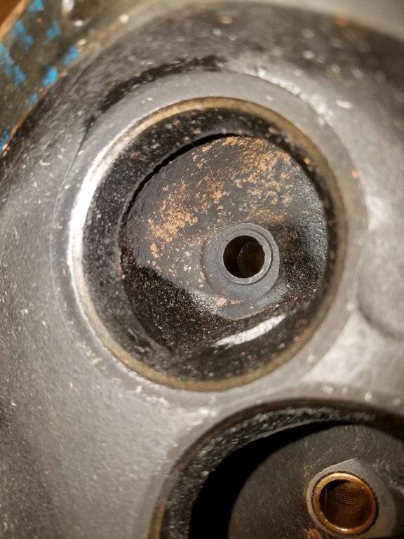

I have to go pick up a spring compressor then I'll check the bowls. I know they didn't touch the ports since it looks like there is a pentastar in a few of the intake runners. I am going to use them since I have them. I didn't really make the post to see if people like those heads or not, I just want to learn as much as I can about these old cars so that I can help keep the hobby alive.

I believe it is from a different foundry from where 906 where cast. Basically the same head. The flow numbers will be right in line with 906 castings.
I had a set of these when I was gathering parts for my ‘68 RR and in my research I found what Dave ^^^ said to be most likely, same as the 906 just from a different supplier.

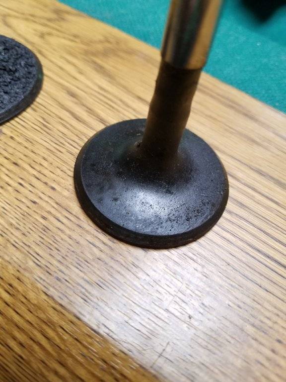

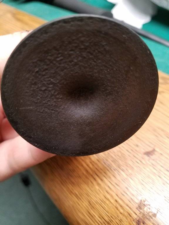

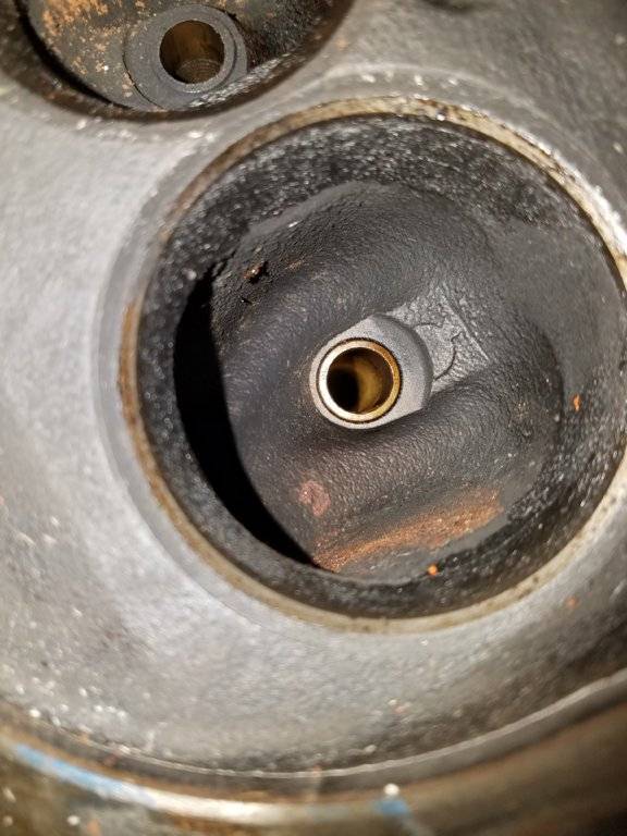

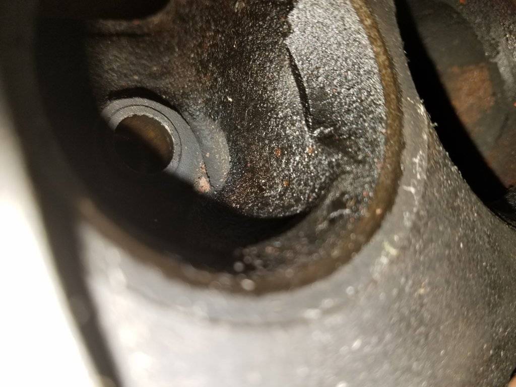

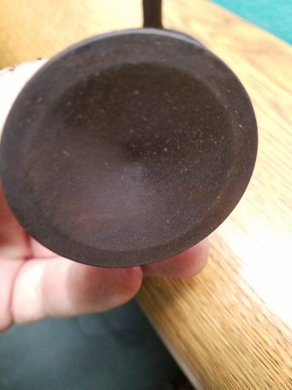

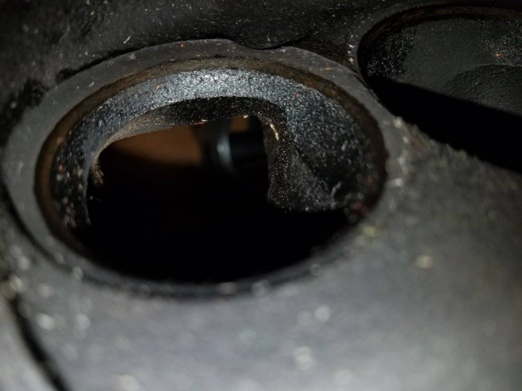

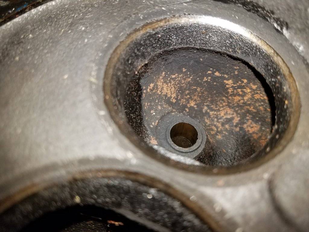

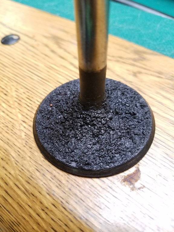

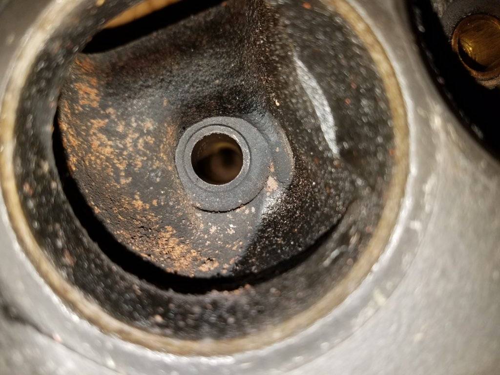

Here is what I found so far. I cc'd the chambers at 85 and the intake valves have a lot of carbon on top of them. Here's a bunch of pictures of them and the ports for future reference.
