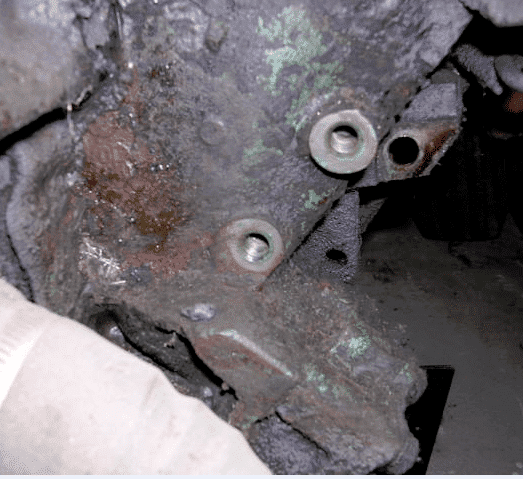

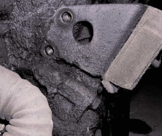

Here's a shot of the factory '65 driver's side mount forward attaching point.
Now without the mount showing the holes (reference the oilpump).

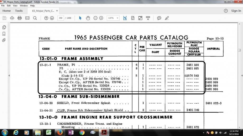

This really piqued my curiosity, so I opened my copy of the 65parts manual and found this:
There shows two stub frames for the Plymouth. One for the 6 and one for the V8. It also shows a different part number for the Chryslers and Dodges. That doesn't mean the Chrysler frame won't work... It just means that it isn't the same.
That tells me that you can use the Plymouth stub frame that's in the car now.
Your page show 66, not 65.
