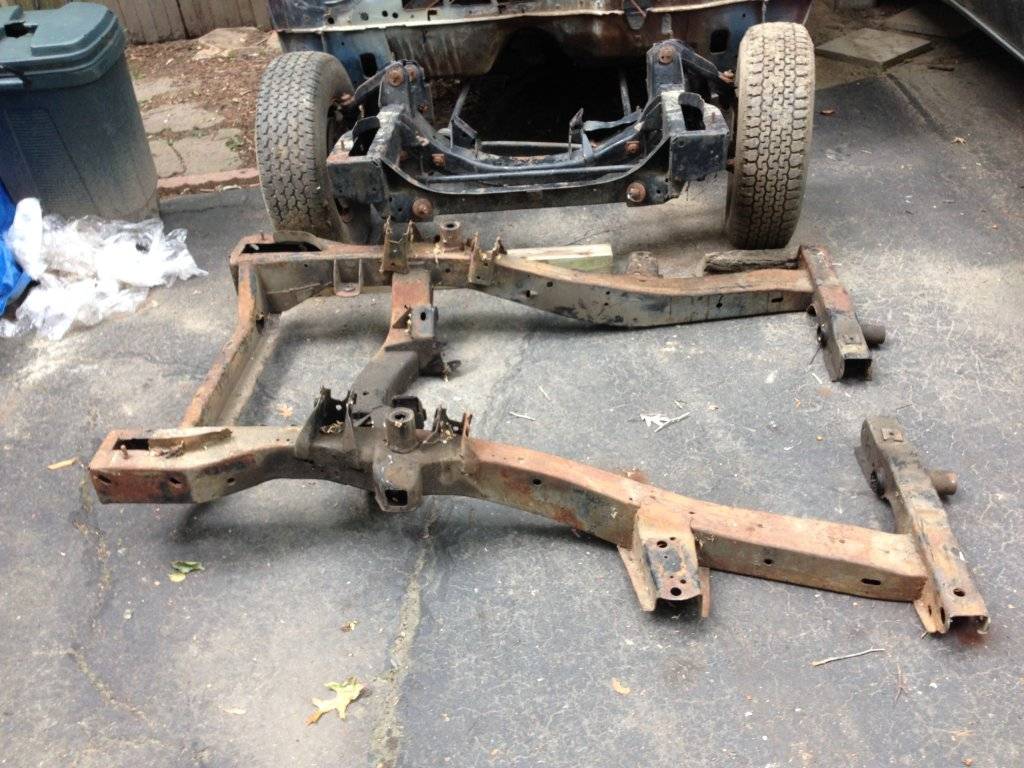

anyone know the weight (or close est.) of a stub frame for 70 fury stripped of everything except torsion bars?

I just checked my Fastenal reciept when I had my 70 Chrysler stub shipped from CA and it was 150 lbs before it was packed on the pallet, if that helps.
47 inch torsion bars weigh 20 lbs for the pair.
Specifically, the lighest ones (.94 inch diameter) weigh 19.8 and the next size up (.96) weigh 20.4 lbs. The torsion bars will fall out unless the lower control arm is also still on the stub. They're heavy.
