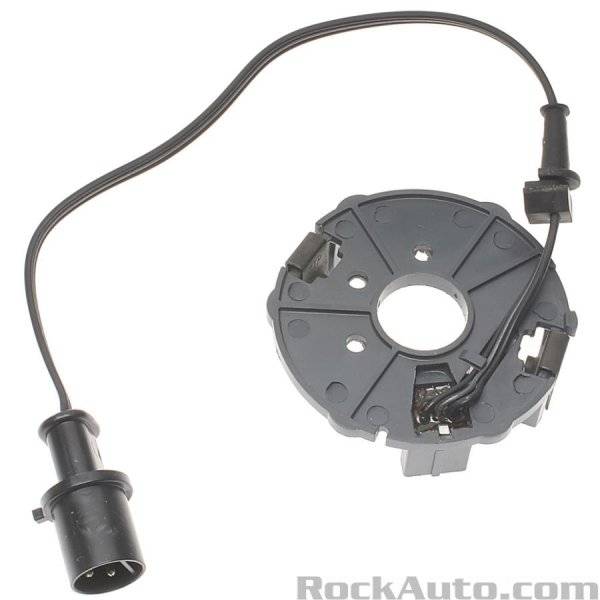

I cant find any ccrank sensors or cam sensors listed as parts in the typical parts stores including rockauto
I believe the name of the part is hall effect sensor. STANDARD MOTOR PRODUCTS LX127

I had a similar problem on my '89 Dakota with the V-6. It was the Hall pickup. After I replaced it, I looked at it and it was very corroded where the rotor swung through. I wondered it cleaning it up would have got it running again....
The one in the photo is the early type. Later 318's have a cam sensor located behind the water pump housing. Not sure when they made the switch. Dave
Post 1993 for sure, probably with the advent of OBDII in 1996 2¢
I have noticed there is corrosion on the rotor shaft so corrosion on the hall sensor is likely, i have ordered a new one and will see when i open the dizzy up properly.
