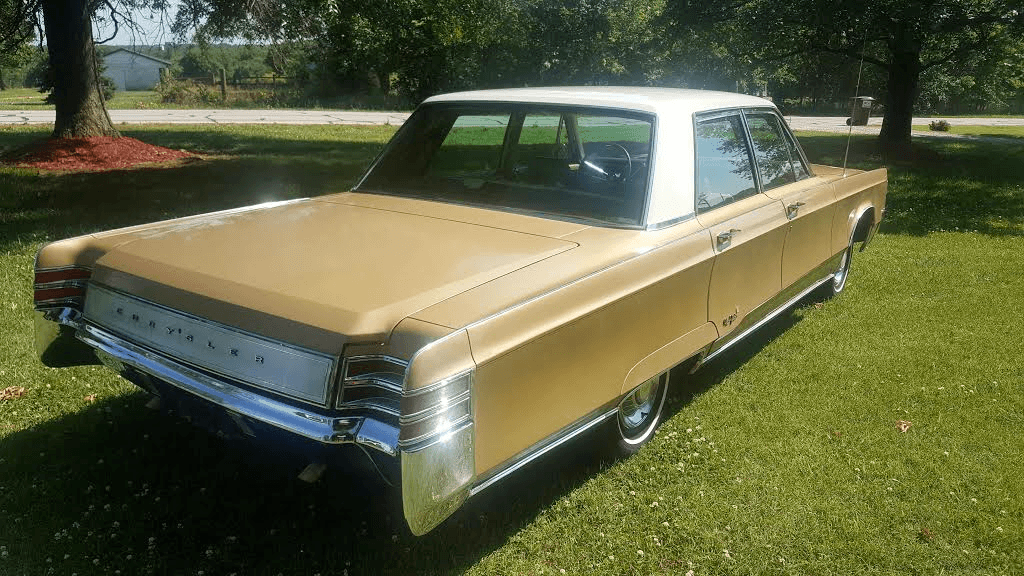

For a "late winter" project I'm planning to work on (to the extent that I can) the original paint on my '67 New Yorker, which everyone on here is probably familiar with (and hopefully not tired of by now) The original gold finish is in good shape, showing a little wear in spots, and light cracking in 1 or 2 places. Ditto for the white top, which shows more wear, but no cracks. Generally both present well, and are preservation worthy.
While LOOKING good there isn't much of a shine, and if possible, I'd like to bring some of that out. However, I'm not keen on trying just any old wax or polish. Not experienced with a 50+ year old finish, and don't want to try anything without some guidance.

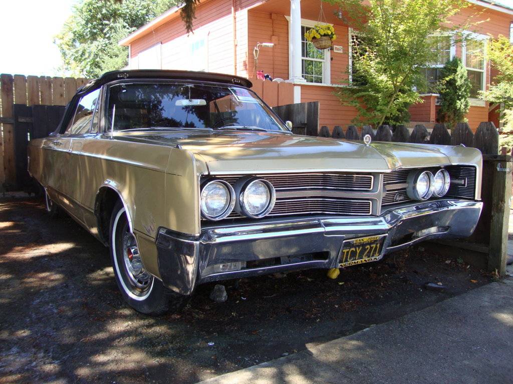

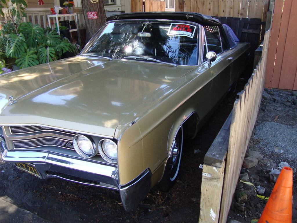

i used a carnuba paste wax on my 67 300 rag . ,it was oem finish . carnuba wax don't leave a white film , it dries to a dull . then you work it off and then polish rag to pull the shine up . by hand no machine .
it waas a great ride , and the new owner is enjoying it . i've still have two more 67 300 rags . one in process , one waiting . i guess i could wax up my yellow one . paints a few years old , never cut and buffed it .
These 300's were up for sale on Craigslist a some years ago at least. I remember four of them in an ad dating back to 2012.
yes , that was me . i've cut down my hoard a bit . just two left the yelllow and silver . sold the gold and the white ones . both drove away .
