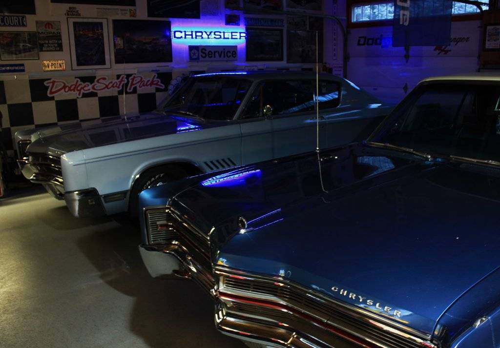

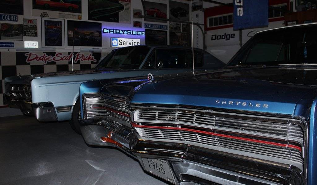

Sum pics of my home made, backlit CHRYSLER sign
MOVE N UP
Apr 25, 2015
671
2,284
Maine

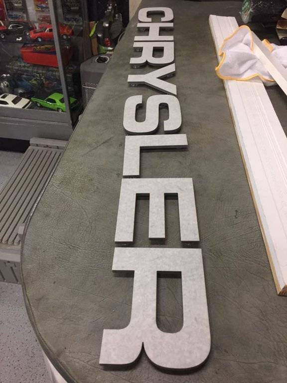

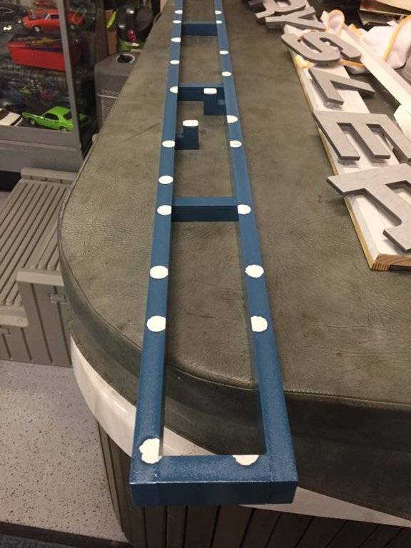

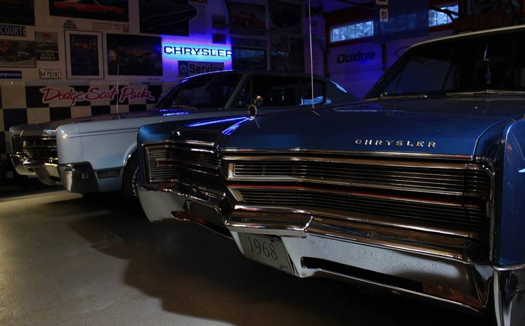

I purchased some materials and made a new CHRYSLER backlit sign for the garage
5" x 1/4" acrylic letters from americansignletterscom.

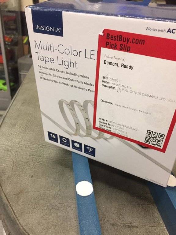

16' LED tape strip from BestBuy

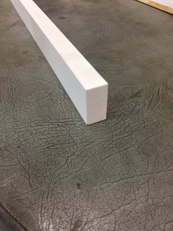

2x1 PVC vinyl trim board from Home Depot.
I created a frame and plotted the letters onto the frame. I then covered the areas where the letter pads would be glued on, and painted the frame with Chrysler turquoise engine enamel.

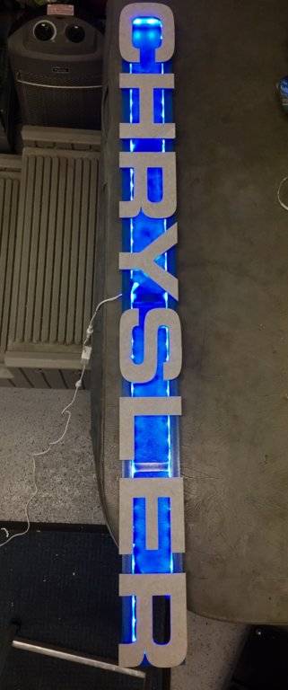

Before affixing the letters I applied the multicolored LED light tape, then glued on the letters with PVC "Goop"brand glue

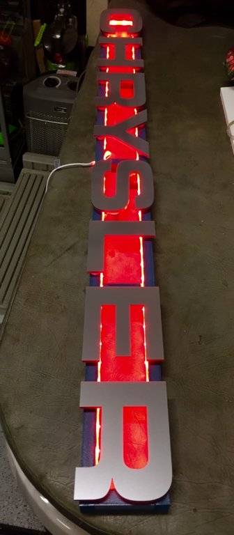

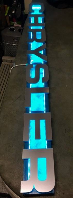

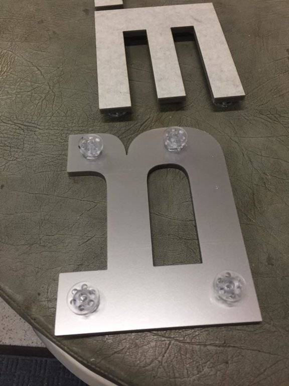

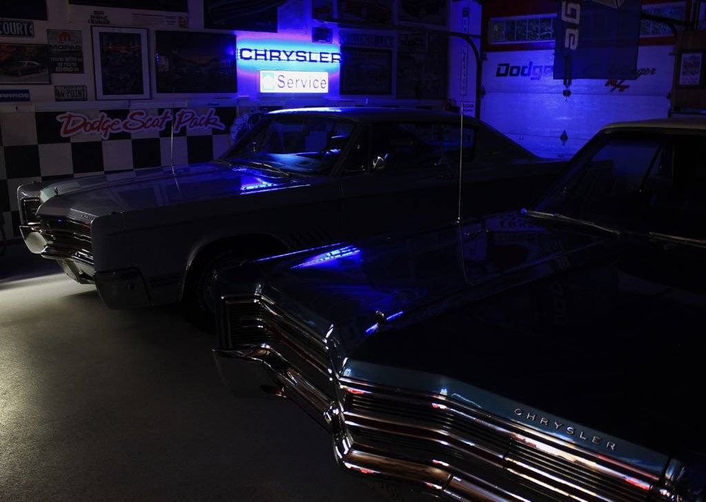

That looks great! Why does it appear multi-shaded? Can you post a pic showing how the light tape is attached?
Thanks guys!
The LED strip has a 3M adhesive tape to affix it to the surface. The multi color is just the glow it gives off in some photos.... here are a few pics during construction - showing different color lights
