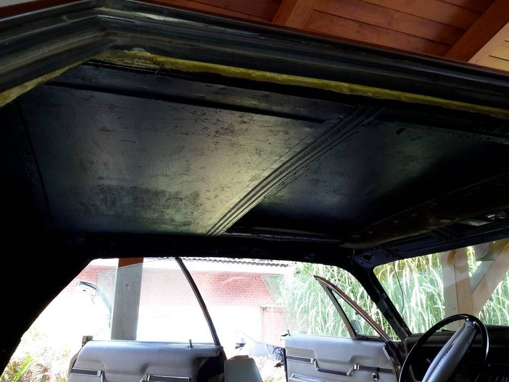

Hi guys,
I wanted to remove the sunroof frame of my 73 imperial to unrust the roof. So I removed all the screws but the frame seems to be welded to the roof in the front half!
Did anyone resolve this problem before?
Thanks, Dirk
Get yourself a spot weld drill bit..
Drill the spot welds...
If you have not heard of such a thing here is a vid
explaining and showing how to use...
are you going to put the sunroof back after you sort out the rust or replace the roof?
any pics?
I've never opened the roof on a sunroof C-body, but I am familiar with them on B-bodies and would be very surprised if they were done differently.
The sunroof "cassette" (moving parts and tray) is a bolt in. There may be a sealant at the forward edge. As I recall, the only sheet metal difference is simply a 90-degree flange that surrounds the forward edge and sides of the opening. Be sure your do further research before drilling any welds!
The sunroof works fine. So I think i will leave the cassette where it is and remove the rust so far I can.
Drilling seems me to risk.
