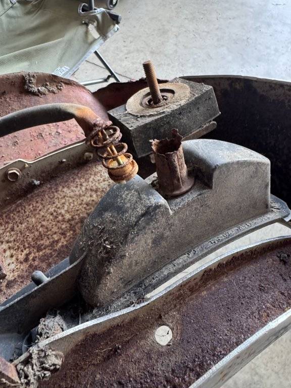

Does anyone know where I can get replacement tail light housings on my 1970 Plymouth Fury III? I can’t seem to find them anywhere. Or is there a way to fix the socket that has rusted out?
Thank you so much! I couldn’t get them to pop out with the rust, so I wasn’t sure if it was all one assembly but that makes sense. Really appreciate it!

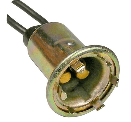

Just buy a replacement socket. You will need one for a dual filament.
Looks like this:
