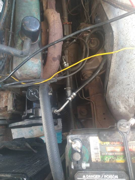

Such waste typifies military procurement in the U.$ from George Washington's command to this very day. Heaven or Hell only know what these were actually meant for. Here is the relatively new hose cannibalized from Mathilda, as the pump its attached to in this pic;
The replacement pump is none other than the same one I found this past Spring for about $80, rebuilt from a 1959 Imperial. It doesn't leak, turns very easily, and delivers power to the gearbox. My sole complaint is using the 5/8" low pressure hose for the return line, but, such large diameter hose assures the return line pressure WILL be LOW, and once I install the cooler I also got this Spring, it will keep this power steering system COOL. My sole expense for today's replacement was for several quarts of power steering fluid, used to flush the old stuff out.
