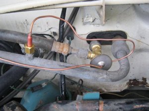

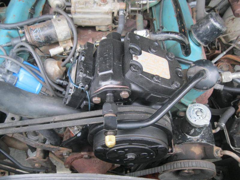

Did the R134a swap, new compressor, dryer and expansion valve. Didn't have a T-stat as we didn't know it was needed at the time, so for now, I THINK he left the EPR valve in place. Ran the car for about 45 min yesterday and it was smooth and quiet. Didn't have a thermometer to check the vent temp, but it feels pretty good, not REAL cold, but good. If when I check the vent temp its not cool enough then I guess I'll go the T-stat route and remove the EPR and see if it gets any better that way, we'll see. Now, on to the next project....disc brakes. :yes: Thanks to all who helped with tech answers. IMG_0053.jpgIMG_0055.jpg
I'll go for a ride but I'd opt for the windows rolled down.
nice job on the install, it looks great.

I'm leaving it in. Even though my heater A/C box wasn't working (no air flow coming out of the vents) I was still getting 48 degree temps at the vent. So for now, I want to leave it in..I think it'll work just fine.
It's just that if you want to remove it later, you'll have to purge and capture the system.
Not a problem. If the system works properly with it in I'm going to leave it alone. If not I'll remove it and go the other route.
