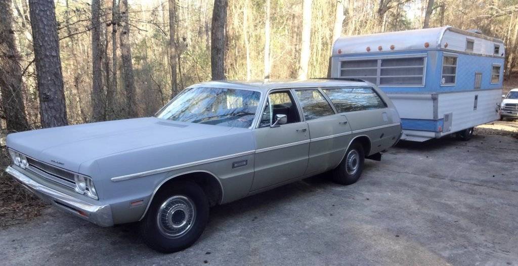

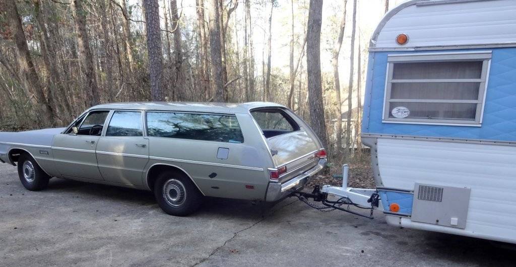

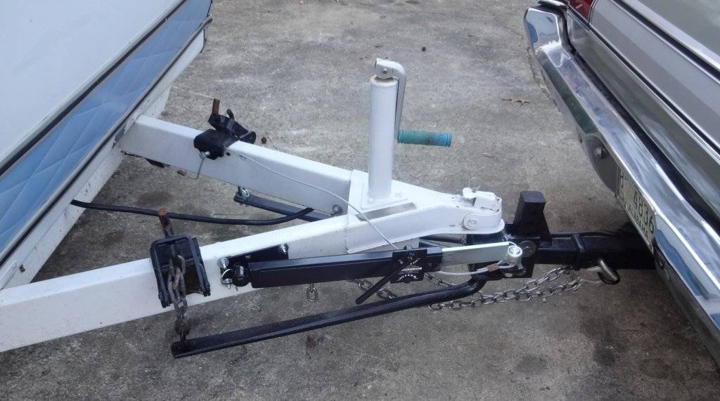

The new spring package on the Admiral holds the trailer weight just fine now. With the new adjustable hitch everything is setting level and the stabilizer should improve handling. I may go back and remove one leaf from the stack up because the ride is a little rough and He sits a little to high when disconnected.
We leave for New Orleans next Tuesday, then back to Gulf Shores for a week. I'm anxious to see how it feels going down the road.
