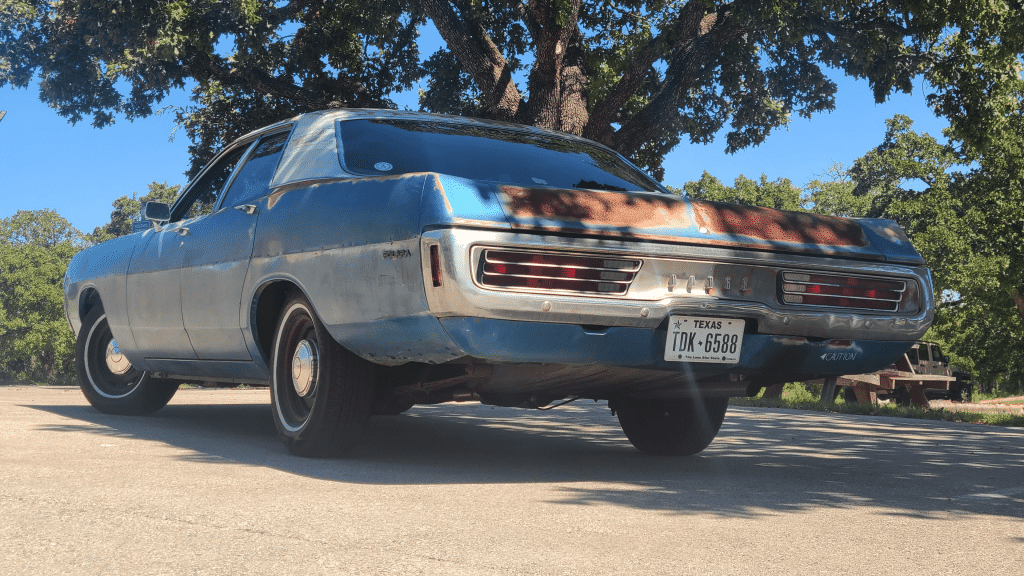

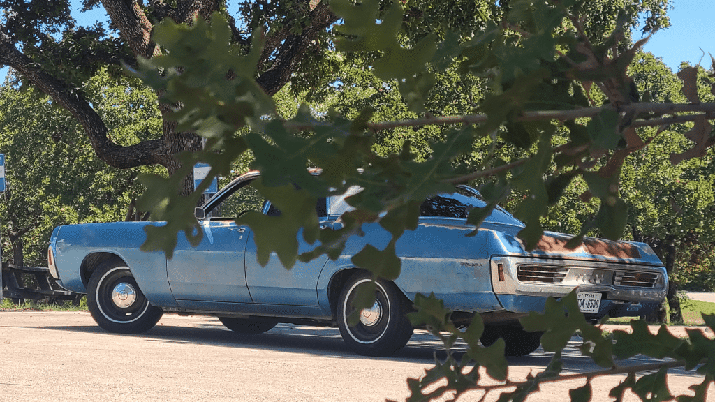

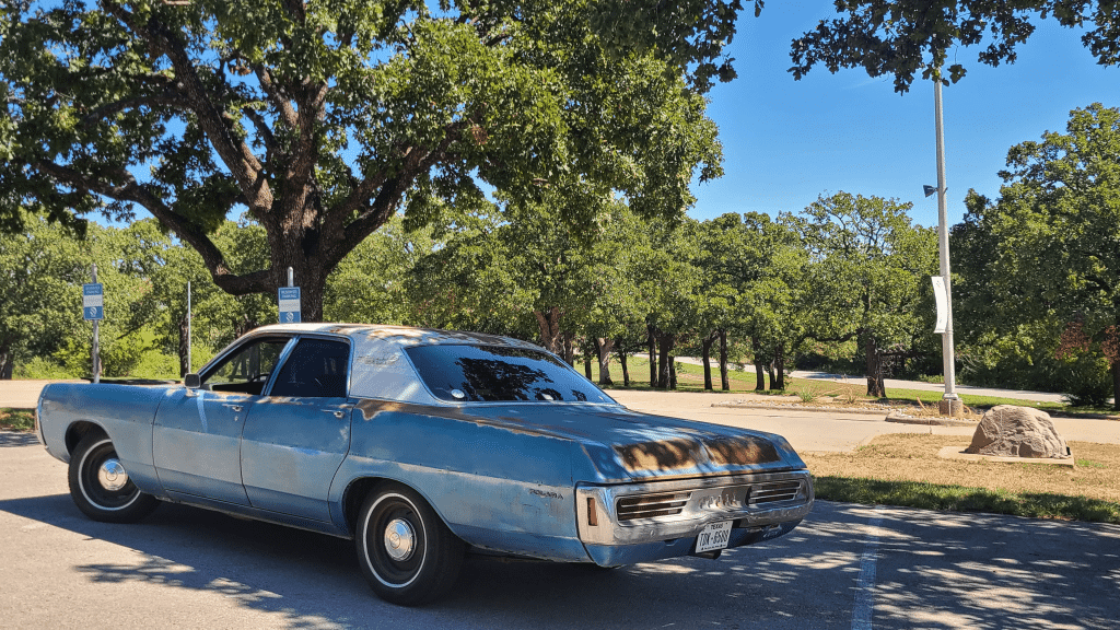

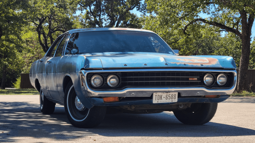

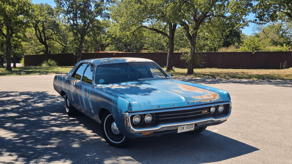

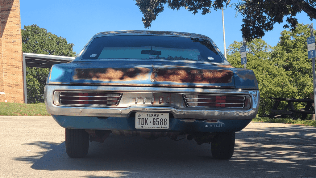

1971 Dodge Polara, base, 4 door sedan, 383 2-barrel, 727 transmission, all manual drums. FQ5 Coral Turquoise, black interior, black vinyl top (long gone), black carpet, black everything; pretty much no options or as basic as you can get, I believe radio and A/C were the only non-standard things it was purchased with. It either has 122,000 miles or 220, but I'm leaning towards 120. Bought for $3,100 in driving condition January 2023. This is my first pre-80s vehicle I've owned, and my first American car (I own a Plymouth Voyager, but haven't gotten it driving yet, and not really a car), and I've been in love with all things fuselage ever since I was introduced to them, so C bodies quickly became one of my goal cars to own, and the 71 Polara in particular was among my favorite of the fuselage designs, so I spent about a month looking for a 71-72 Polara and going through options and eventually settled on a listing in Phelan, California, so drove cross country to pick it up and trailered it back - around ~3,200 miles of driving in total. Dailied it for a good while, then had a couple hiccups where it wasn't driving for some periods, but now it's back to being the daily driver, and it's the car I use for every little thing; so long as it drives, I'll be using it. It was designed to be, in Dodge's own words:
Polara meets the needs of the budget minded buyer seeking good looking, reliable transportation at a low price.
And that's exactly what it is, what it does, what I wanted, and how I use it. And I thoroughly enjoy pretty much everything about it.
Although I would be pretty interested in owning a 72 Fury, 72 Monaco, 70 Newport, or 69-70 300 some day, I've got to say I have pretty much no complaints about the Polara, and love how it drives and feels.
It was suggested I make a standalone thread for this, so figured might as well keep this as a record/blog of sorts to keep track of everything. Despite owning it for a while now, only yesterday got a chance for my first real (though still casual) photoshoot with it, so thought I'd put those pictures here and write down basically where everything's at as far as problems and goals and directions with it. It is rust-free, and the only rust that is present is surface rust, which I plan on addressing when able.
My budget will always be as low dollar as possible for the foreseeable future, since I just don't have hardly any money to begin with, so getting things done will be slow and cheap, but if it can be done with minimal resources, it will be tried.

· Shaking: After getting it driving again a few days ago, it now shakes about 2-3x as intensely as it did before. There was always low idle vibration, but it was pretty mild. Now the shaking is getting pretty heavy by comparison, especially if you have it idled in drive with the brakes on. At higher RPMs, such as park or neutral, it smooths out more, but it's still more present than it was before.
· Braking: Also something new since getting it driving again recently, when braking it no longer brakes completely smoothly and it behaves sort of like it's going over a flat spot on a tire, but that's not the case. Just got an alignment as well, so still trying to figure that one out.
· Steering: All in all, pretty good, though the front suspension needs new bushings, and possibly ball joints, though at that point may need to look into the control arms as a whole eventually. Just wear.
· Backfiring: When engine braking or decelerating in lower gear, it'll do a snap, crackle, pop burbly sort of backfiring, but not at any other time.

The soot on your rear valance suggests it's running too rich. Dial the mixture in and your "shaking" at low rpm may go away...
Car looks good! You can feel the exhaust output at idle to see if it might be a burnt valve causing the shaking.
Enjoy!
CBODY67
Sweet ride, and i do like the pics, keep em' coming. The more i drive my 2dr Newport, the more i wish it was a 4dr ! Keep rollin' and don't give up, you have a good car to start off with, and that's a very big plus.
