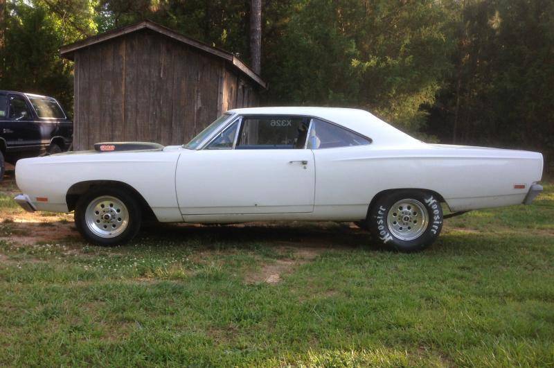

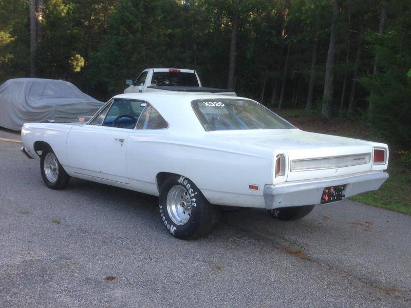

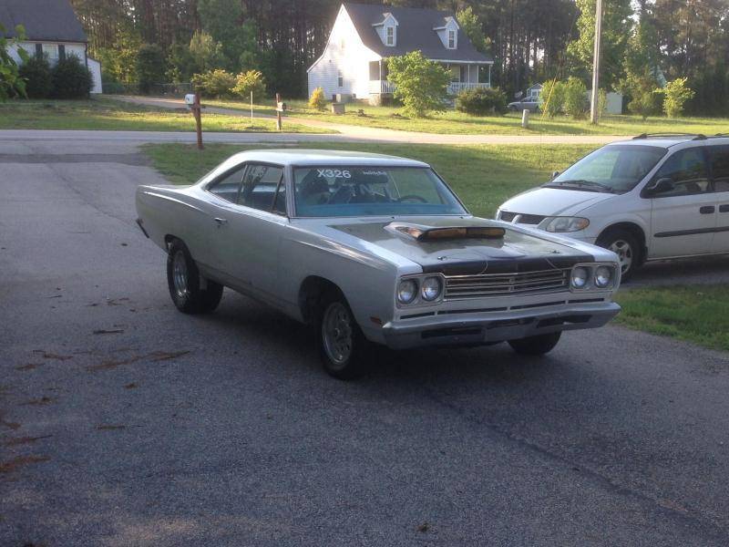

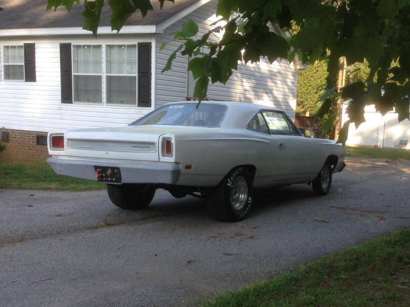

So after being in the shop on stands for the past 2 months I finely backed her out under her own power. New 3K stall converter, mini starter, Super Stock springs, Comp adjustable shocks , wheel studs & open lug nuts.and 29 X 10 slicks. She is sitting about 3 inches higher in the rear. I called Mancini Racing & ordered some pinion angle shims to correct that. Still need to get some spacers to help the slicks clear cause its a bit close. Did a couple of dry hops in the driveway with the converter at 1800. It felt good. Now finish the details, give her a bath & find the time to get it to a track. That was a lot of work. Sure hope it pays off.

Very nice Bob. I have had a few of those in my day. Large, light, and fast. Now, let's line it up with one of my Malibus....
Thanks Andy. I'll race anybody bracket style, but heads up....naaaaa Little ole 318 street motor in the car right now. A friend gave me a 440 , but its smokes a bit. So maybe next year she will have some serious hinney. Its going back on the stands tomorrow as more parts arrived. After I get this stuff installed I'm gonna play even if I have to push it down the track. Tired of working on it. --->for now...LOL
Very nice car and looking forward to you posting some times.
Thanks for the comps. It looks better in the pic's the in the steel. Needs a new paint job. Its just a 318 bracket basher. Curently runs 8.70's shifting at a lazy 4600. Just completely redid the rear suspension along with a new converter and a few other changes, so hoping for a 8.60 or better. Ok I'm really hoping for an 8.50 to be honest, but it make take a while to dial the shocks in.
1/8 mile...right? Had me fooled with how the car looks! I thought it was a 10 second car. After the 440..! What do you have done to the 318 to make it that fast? If the car is running an 8.70 in the 1/8,...I would think it would be in the mid to upper 13s in the 1/4. That's pretty nice! My buddy back in the 80s had 440 69 Cornet. Car was crazy fast and fun to drive in. Keep us posted on the times. Your car is badass.
