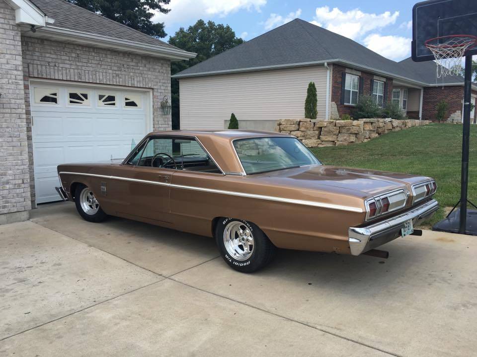

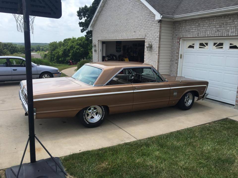

Alrighty ill start out with an update its a 66 Plymouth Fury 3 with a good built 440 mated to a stalled 727... wanted to FILLLL the wheel well and I managed to fit with ease a 275/60/15! so for any one else wondering about a rear rim/tire for your Fury let me know I bought and test fit multiple wheels...

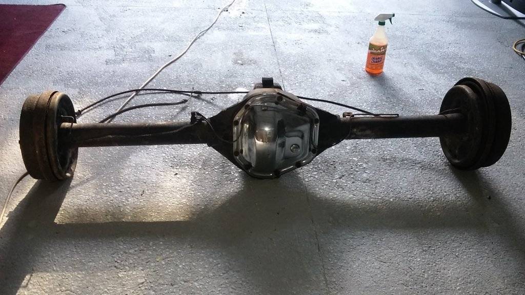

Mine has 275/50/15s, same here, fits easy. I will be installing a leaf spring location kit for the Dana, we will see how much room that frees up.
I don't know who said that couldn't be done - obviously people that failed at it! I have 275-60-15 fitted behind my fenderskirts, with 8" Ramcharger wheels with 4" BS. I used a slightly-narrower B-body rearend/offset mounts/shackles to gain about 1" per side. Fits perfectly with no frame mods.
Wheel BS is crucial to fit that size.
