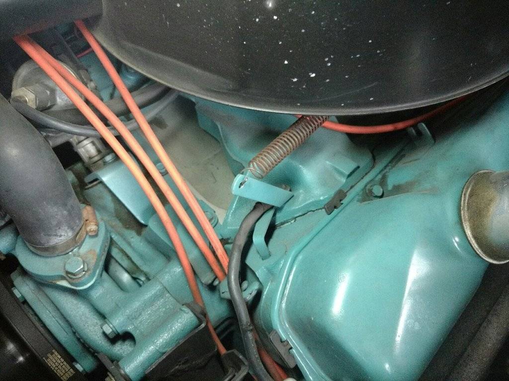

I'm removing the factory AC from the 440 in my 68 NYer. In removing the factory AC bracket the bracket for the throttle returm springs is going to end up being mounted about 3/4" - 1" lower.
Is this lower angle going to impact the function of the springs? Was there a taller bracket for a non AC car?

Here's factory non ac set-up. That bracket shouldn't be difficult to find, I may even have an extra.

Is the spring bracket mounted on top of the A/C bracket or under it? It is supposed to be mounted under it. If that is the case, then the lower position would be correct, and you would be good to go.
Spring angle doesn't usually impact the throttle, but can impact the kickdown lever.
Matt,
Thanks for the picture. Mine definitely doesn't have the tab that extends over to the other bolt hole.
Mine was mounted on top of the AC bracket. That was what caused my concern.
